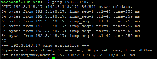

[1722084067] unbound[709:0] error: udp connect failed: Network is unreachable for 192.36.148.17 port 53 (len 16)

It seems that unbound is suffering from network connectivity issues. Can you ping? Like this:
ping 192.36.148.17
If the ping fails, there is probably something wrong with IPv4's default routing to the internet. The most likely cause is issues with the IPv4 configuration of that machine. Is it DHCPv4, or static configured? DHCPv4; check the DHCPv4 server settings (it's likely your home router). Static; check your local IPv4 configuration. Is the default IPv4 route set correctly?
Does another computer on the same LAN, have the same problem? Yes; it's more likely the home router that is at fault. No; it's more likely an issue with the unbound server's computer itself.
If the ping succeeds, there is something wrong with UDP and/or UDP port 53. In this case it's likely firewall issues of some kind. For example: some home routers play games by redirecting UDP 53 in various ways.
The above are merely general tips. Troubleshooting network connectivity issues can complex.
Good Luck!
Yes, I have tried to ping the IP address from my computer. The ping works. I am outside right now, when I get back, I will send a screenshot.
