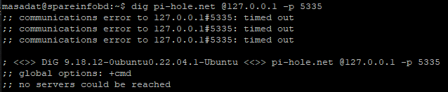

Unbound doesn't work, connection timed out
I install Pi-hole and then unbound. Unbound works.
Ubuntu 22.04
Raspberry Pi
Pi-hole works like normal, but Unbound receives the DNS Request (i checked the logs), and simply doesn't respond, like at all.

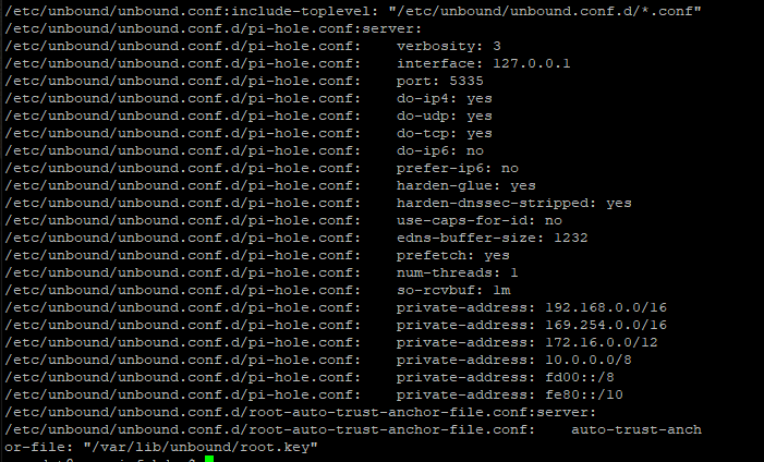

Only non-standard change I made was changing verbosity to 3 to try to figure out what on earth was wrong with it. After an entire day of troubleshooting, I am at the end of my rope. HELP.

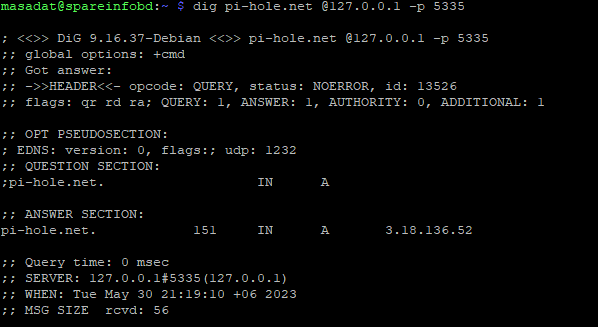

What's the output of:
dig pi-hole.net @127.0.0.1 -p 5335

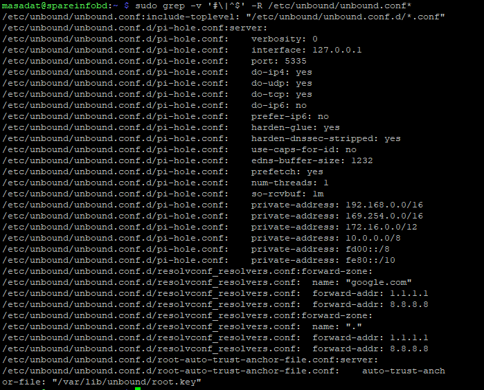

Also, let's take a look at your unbound config
Sorry for being 20 hours late! Here you go.
Edit: Oops! Forgot this,
Your unbound configuration looks normal.
Your dig result suggest that unbound cannot be contacted.
Did you verify that unbound was active at that time, e.g.
sudo systemctl status unbound

Below file miss configures unbound to function as a simple regular DNS proxy/forwarder/stub resolver instead of a full blown recursive DNS resolver:
/etc/unbound/unbound.conf.d/resolvconf_resolvers.conf
Ditch that file with below:
sudo rm /etc/unbound/unbound.conf.d/resolvconf_resolvers.conf
And and make above change reboot persistent by hashing out below line (put a hash sign # in front of it):
pi@ph5b:~ $ sudo nano /etc/resolvconf.conf
#unbound_conf=/etc/unbound/unbound.conf.d/resolvconf_resolvers.conf
And run below to apply:
sudo systemctl restart unbound.service
And check status:
sudo systemctl status unbound.service
Nope, stopped working again. Same error. Tried your command, no dice though. Had to wait for exams to finish, hopefully can respond more.
https://tricorder.pi-hole.net/y4Pd501e/
The root problem seems to be that Unbound gives absolutely no response, despite it apparently running and being correctly assigned the port 5335, and there being no firewall.

Are you sure that file didnt return?
cat /etc/unbound/unbound.conf.d/resolvconf_resolvers.conf
Whats configured for local DNS?
cat /etc/resolv.conf

pi@ph5b:~ $ sudo nano /etc/unbound/unbound.conf.d/pi-hole.conf
    verbosity: 0

From the screenshots (the red lines) you can see unbound is having troubles communicating with below essential DNS root servers:
pi@ph5b:~ $ dig +short -x 199.9.14.201
b.root-servers.net.
pi@ph5b:~ $ dig +short -x 192.33.4.12
c.root-servers.net.
pi@ph5b:~ $ dig +short ns .
j.root-servers.net.
a.root-servers.net.
c.root-servers.net.
d.root-servers.net.
i.root-servers.net.
l.root-servers.net.
g.root-servers.net.
b.root-servers.net.
h.root-servers.net.
m.root-servers.net.
e.root-servers.net.
f.root-servers.net.
k.root-servers.net.
This could indicate that there is something going wrong on the path to those root servers (eg UDP packet size), or some DNS filtering going on upstream (maybe your ISP).
Check your router for DNS related security settings like filters or redirecting DNS!
For both above problems, you should ask your ISP for support!
When things go south, do you get below same similar reply?
pi@ph5b:~ $ dig +norecurse @199.9.14.201 ns .
; <<>> DiG 9.16.22-Raspbian <<>> +norecurse @199.9.14.201 ns .

I set verbosity to 3 (or 5, i forgot, but later i set it to 3). i did dig google.com @127.0.0.1 -p 5335 and checked the journal and it said somthing about query and google.com. at this point, i felt pretty sure that unbound was receiving queries and just not responding to them. and so i went searching from forum to forum for answers, reinstalled ubuntu a bunch of times, none of their solutions fixed my issue, and then...
you know what happens next. in fact, with the exception of
one single day of actually working, unbound returned to it's old ways. finally my father had enough of not being able to do anything, changed the dns, and my exams finished,
giving me a whole another chance to crack this mystery, and here we are now.
hopefully that should clear things, but i went to this whole detour to prove a point and that is that...
unbound has and had no uptime, throughout almost the entirety of this post.

Without this connectivity, there is no way to get unbound working as a recursive DNS resolver.
unbound might have worked for you in the past, but that could have been bc of that unwanted config file:
As mentioned, this file configures unbound as a stub resolver instead of a recursive resolver and that works differently without any root.hints.
EDIT: FYI, the pihole-FTL daemon also functions as a stub resolver.
