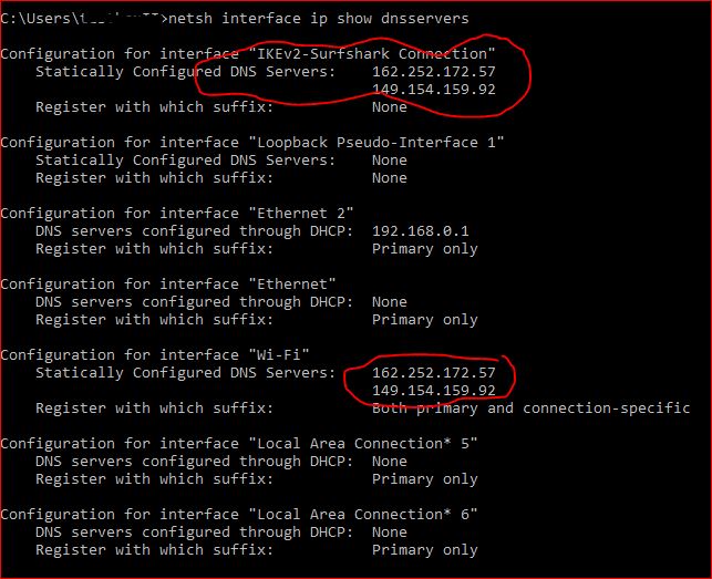

my output is the following.
i am on wifi to my router with vpn enabled via a opvn file.
i did not need to add 192.168.0.68 to the ovpn file.
192.168.0.68 is my pi-hole reserved ip in dhcp via router.
my problem is its cumbersome to change vpn region via the router interface when i want to..
using the vpn provider's windows client is much faster to toggle regions.
unfortunately while using the app, and this is surfshark too, there appears to be no way to avoid using their DNS servers (that i know of), or in other words continue using the pi-hole when their vpn windows client is in use.

Can you copy paste instead of those screenshots pls ?
Enclose the code with the </> button before posting.

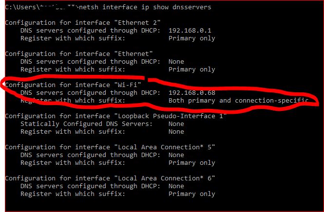

flushdns didn't work but what did work is the following:
C:\WINDOWS\system32>netsh interface ip show dnsservers
Configuration for interface "IKEv2-Surfshark Connection"
    Statically Configured DNS Servers:    None
    Register with which suffix:           None
Configuration for interface "Loopback Pseudo-Interface 1"
Configuration for interface "Ethernet 2"
    DNS servers configured through DHCP:  192.168.0.1
    Register with which suffix:           Primary only
Configuration for interface "Ethernet"
    DNS servers configured through DHCP:  None
Configuration for interface "Wi-Fi"
    DNS servers configured through DHCP:  192.168.0.68
    Register with which suffix:           Both primary and connection-specific
Configuration for interface "Local Area Connection* 5"
basically I have to delete the DNS off of this interface but don't ADD back the pi-hole.
Then i'm able to load web pages.

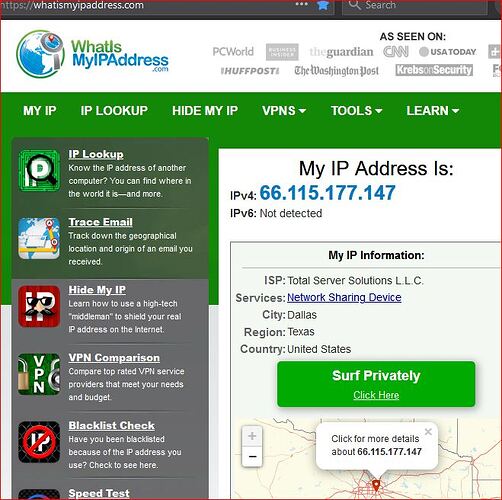

Then i went to verify that the vpn app was still working and having me at the right region (dallas) and it is!
cool.... so this seems to be a method to change region but also use my pi-hole...
thanks!
