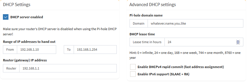

To do so, you first have to enable the DHCP service on Pi-hole like below:

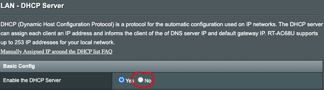

Then disable the one on the Asus router:
