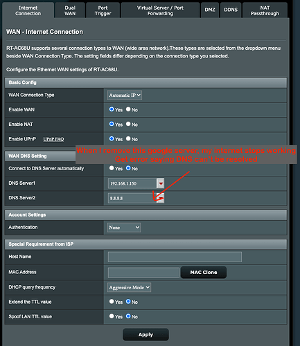

Hello pi-hole community. I recently moved and updated my pi-hole to use v5 and now I'm not seeing any ads blocked nor does traffic appear to be going through the pi-hole. I've tried several fixes as recommended in some posts here but I've had no luck. As soon as I remove the google servers from the 2nd line in my WAN server settings my internet stops working.
I've read issues of ASUS routers assigning their own IP but as I am a noob when it comes to networking I'm not really sure how to fix. Any advice is appreciated, thanks for looking.

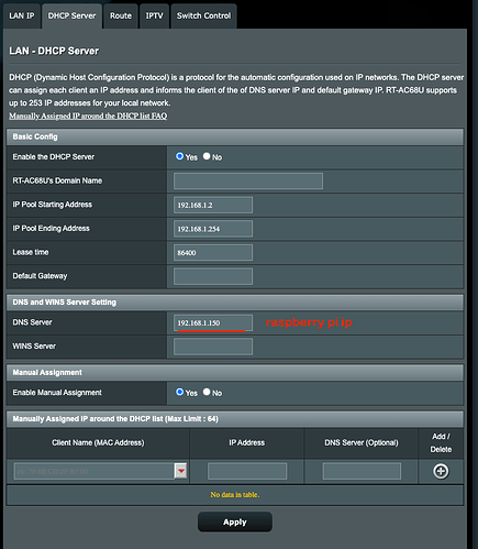

LAN settings in router:
WAN settings in router:

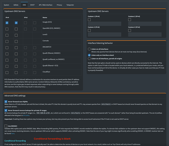

Pi-hole settings:

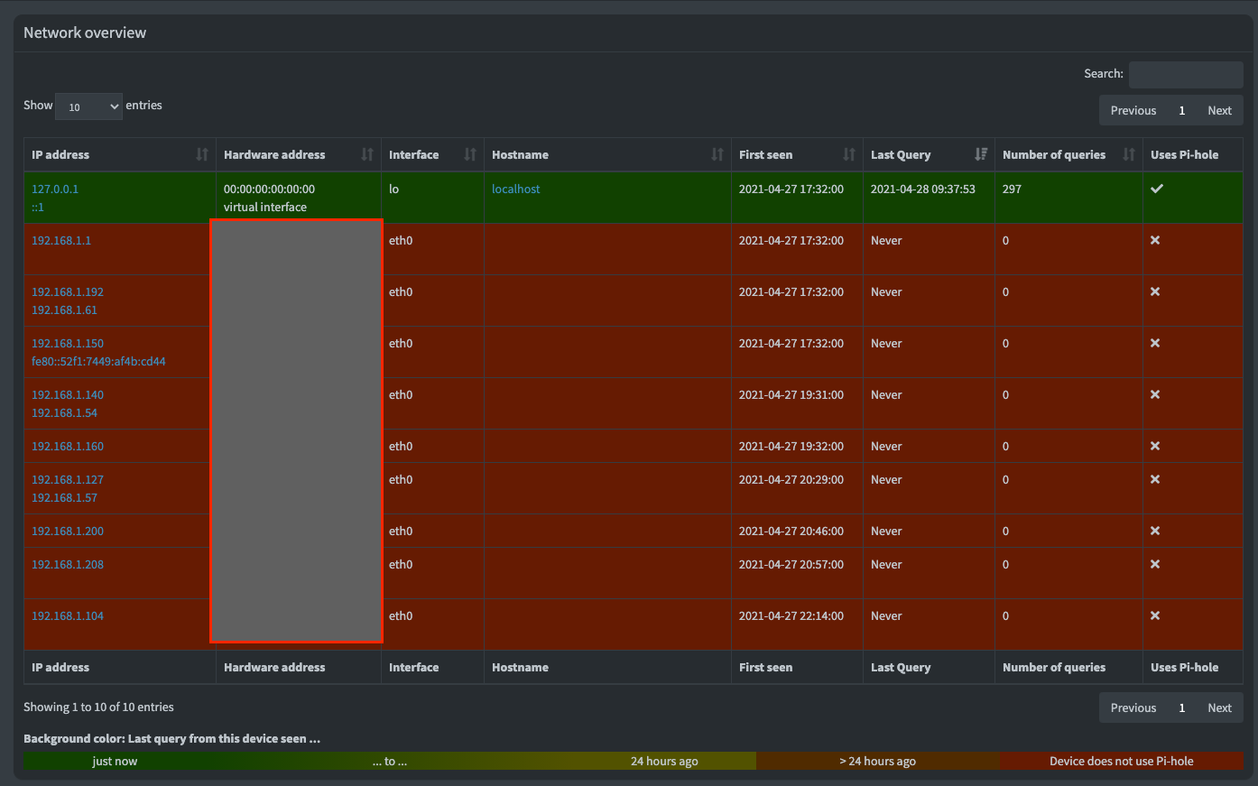

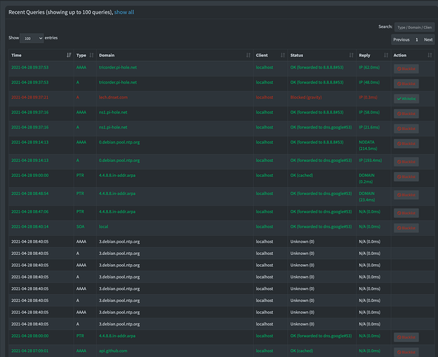

Pi-hole query log (previously when it was working I would see addresses being blocked actively):

   DHCP packets received on interface lo: 0DHCP packets received on interface wlan0: 0
    PIHOLE_INTERFACE=wlan0
You configured Pi-hole to listen on wlan0 instead of eth0. Run pihole -r and choose reconfigure.
Please note: your router does advertise itself as DNS server via DHCP as well. Therefore your clients may choose to send DNS requests to your router. If Pi-hole is working again you should remove the google DNS from the WAN settings again to filter those requests as well.
OMG that was totally it. Thank you for solving this problem for me which I've been stuck on for 2 days now :pray:
I've also removed the Google server from WAN DNS server2 setting so now I only have my pihole ip in both LAN and WAN.

Hi @mundert, am just warning you but probably your setup still doesnt filter out ads etc under certain conditions.
As long as your router advertises its own IP to the clients alongside the Pi-hole IP:
You can see what DNS server(s) your router is advertising when running below one on the Pi-hole host:
pi@ph5a:~ $ pihole-FTL dhcp-discover
   dns-server: 10.0.0.2
Those are the ones your clients will be querying to resolve domain names to IP addresses etc.
If you read below thread (with a nice recap from @bennor3814), best for you would be to replace the DHCP service on the Asus router with the one from Pi-hole:
To do so, you first have to enable the DHCP service on Pi-hole like below:
Then disable the one on the Asus router:
Validate everything Pi-hole is advertising with the pihole-FTL dhcp-discover command again.
Grab a test client (Windows/MacOS or Linux) and dis and reconnect it from/to network to renew its DHCP lease.
Check DNS server(s) this client is configured for now after renewing the DHCP lease:
And run below three on the client in a command prompt/terminal to test name resolution and blocking (flurry.com is on one of the blocklists):
