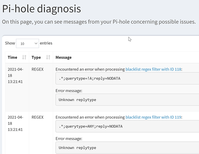

HOWEVER
pihole-FTL log:
[2021-04-18 13:21:41.145 24988/T24992] REGEX WARNING: Invalid regex blacklist filter ".*;querytype=!A;reply=NODATA": Unknown replytype
[2021-04-18 13:21:41.340 24988/T24992] REGEX WARNING: Invalid regex blacklist filter ".*;querytype=ANY;reply=NODATA": Unknown replytype
[2021-04-18 13:21:41.569 24988/T24992] Compiled 3 whitelist and 51 blacklist regex filters for 14 clients in 435.5 msec

Okay, so NODATA works for you but you see an incorrect warning. I cannot reproduce this and, looking at the code I also don't know where this may come from.
I updated the branch with a version that is a bit more explicit when complaining about unknown reply types and should also fix the incorrectly displayed reply type in the Query Log.
edit The CI is lacking behind. The correct version will be vDev-d8c8df39 for your next tests.

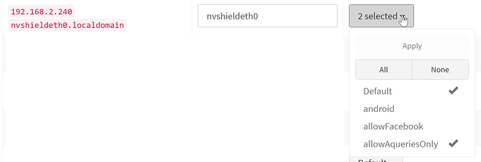

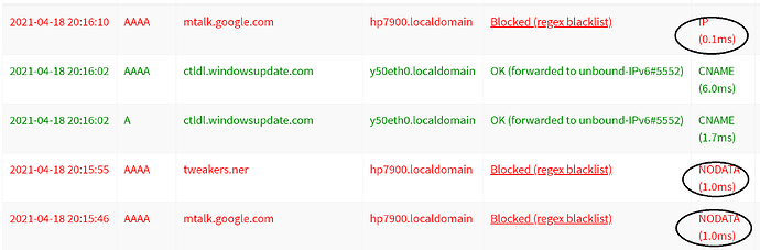

on the windows desktop , the DIG replies do actually register as NODATA, It is the device on 192.168.2.240, for witch the query log always displays N/A.

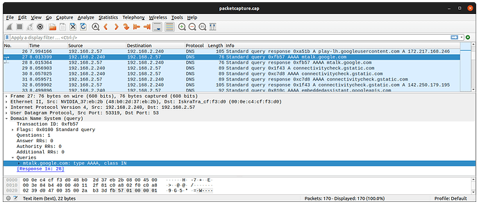

I tested this now, using dig and DEBUG_QUERIES=true, both the DIG command on the desktop and the device (192.168.2.240 - no access possible, black box, so queries are initiated automatically) use UDP. The output in the log is identical. Is the device asking something more / else, than a simple DIG command?
attached packet capture, filter port 53 and ip 192.168.2.240. You'll notice some DNS requests to 8.8.8.8, but the firewall redirects these to pihole.
packetcapture.zip (6.4 KB)

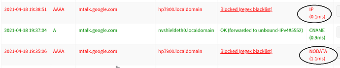

JUST NOTICED, one reply IP, the other NODATA
just asking, don't know the code, does this have something to do with Forcing next reply to 2, and the wrong reply is "forced"?

Who knows. The capture is a good idea, could you generate the same from the Windows machine that behaves as expected? Comparing the two would make it a lot easier for me. Both the question and the reply look perfectly fine (and indeed NODATA).

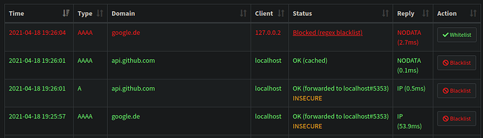

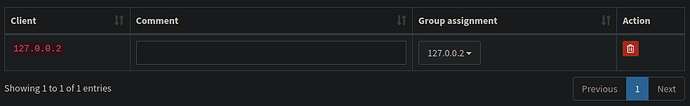

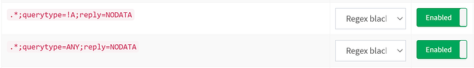

So I tried to reproduce your setup here, correct me if my assumptions are wrong anywhere:
  1. Created a new group
    Screenshot from 2021-04-18 19-19-27
  2. Assigned one client exclusively to this group
  3. Added your regex only for this new group
    Screenshot from 2021-04-18 19-19-45

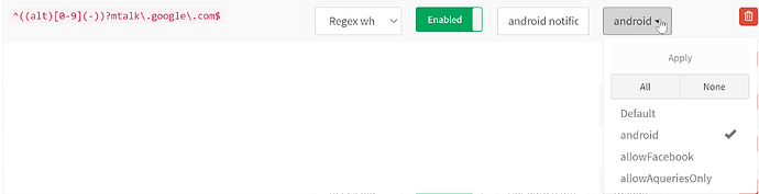

When dig AAAA google.com from localhost it is not blocked (expected, it is not member of the group created for the regex above). If I query the same domain from 127.0.0.2 it is indeed blocked:
Does the link in your
Really go to the regex only meant for the other group?

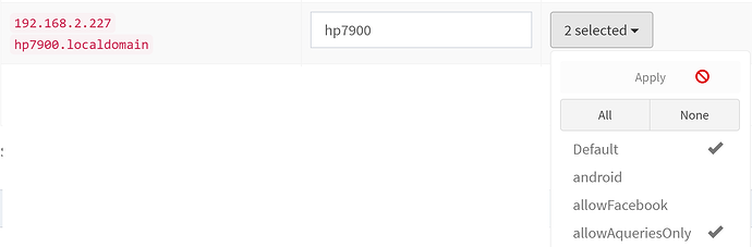

I'm so sorry, I recreated the regex to use NODATA (after the NX DOMAIN test, but forgot to assign it to the correct group, fixed that, AAAA queries are back to normal on that device (with IPv6), again, SORRY....
On the desktop with IPv4 only, client assigned to the regex (via group), with an OK result, started capture, executed dig, stopped capture.

despite my stupid mistake, did you notice, the last screenshot of that post, one query is answered wit IP, the other with NODATA
/edit
edit2
even on the desktop, that behaves as it should, there are some inconsistencies, so it actually behaves a little bit random
/edit2
