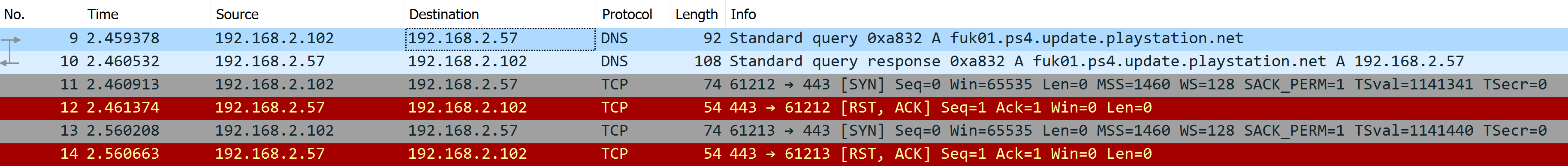

when choosing (on the PS4) settings / the message now is 'an error has occured (CE-34459-5)'
looking at the wireshark output, after getting the address (received a modified address, due to pihole regex), the PS4 immediatlly starts making requests on port 443, which suggests a certificate error would be the result (my pi isn't configured to answer this incoming request, hence the invalid answer).
however, since the mission appears to be accomplished for pihole, the new branch, and thus pihole, does what it needs to do, e.g. reply as if the blocking mode is IP, even though it's really running on blockking mode null
It is now upto @Anuskuss to ensure the pihole replies with a valid answer to the PS4 request to make the circle complete.

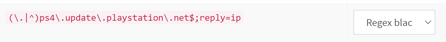

playstation.com;reply=IP
works and is what I'm looking for. Seems like arbitrary IP addresses are not yet implemented though? Just returns 0.0.0.0
right now.
I mean the place to set that up is a little weird (Blacklist instead of Local DNS), and the average users would have problems discovering that on their own (I consider myself the average user and I wouldn't have found it myself), but yeah, this is usable (minus the custom IP address which I use for one of my redirects).
Thanks for testing!
Yes, this is possible by setting
REPLY_ADDR4=192.168.x.y
(docs link), however, it supports only one IP address. That is because the redirection in this way is more an intended side-effect of regex blocking than a real implementation of redirections.
Now comes the usual disclaimer, but I'll say it anyway: Adding edge-case implementations will harm maintainability. Hence, before adding entirely new stuff that may block us from doing other things in the future (the audit feature did so a few times by now), I'd rather like to extend existing stuff. I know, it looks like this could be simple for Local DNS records, however, it'd need a complete reimplementation of the feature because Local DNS records currently live in a namespace that is not aware of groups at all.
If it is only one IP address that is needed, the current solution seems to be the best compromise. If more than one redirect is needed, I can imagine extending the syntax like
playstation.com;reply=192.168.5.9
so any valid IP address is takes as argument. This, however, would out additional storage constraints (incl. bookkeeping about 20 bytes more per entry) for both the list of regex and the DNS cache. Given that the DNS cache records are currently only 16 bytes, this is a significant change.
Good enough for me. Actually, if you get lucky, you could also define REPLY_ADDR6
and maybe get two uses out of it
Yeah, this definitely still feels like a workaround, but is a huge improvement in its current state, because it fulfills most of the points in the OP: I haven't actually tested this on my devices yet (I'd rather do that at night because otherwise my family is gonna complain if something breaks), but this looks very promising. I'm just worried that once I mark this as solved, it means that this will never get implemented "properly", because "it kinda already works".
I'm not going to argue about this - it is a workaround. However, since I don't really see redirects coming any time soon, it is a well-working workaround. I'm not looking forward to such a feature because of aforementioned HTTPS issues. At some point, plain HTTP queries will be gone and this feature would (a) turn pretty useless and (b) cause a lot of questions (i.e. support workload) in the style of "why does this not work as expected".
