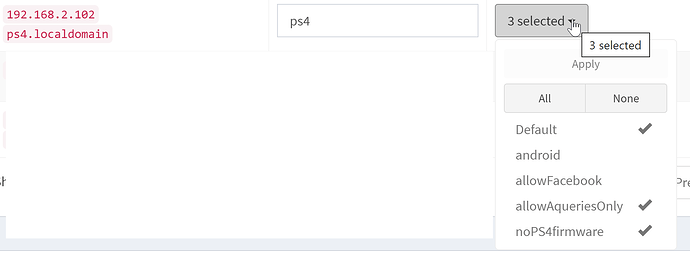

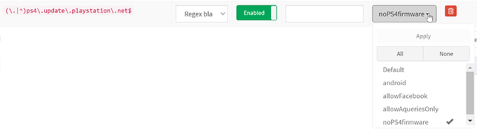

Solving your problem, update one PS4 and not the other, while both devices use a single pihole is simple:
  • add the PS4 you want to allow updating to the default group.
  • create a new group noPS4firmware
  • add the PS4 you want to protect (no updates) to that group
  • create the wildcard entry (see above) and assign it to the noPS4firmware group
done, the PS4 you want protect (no firmware updates) will always try to resolve the domain, but will get an answer, depending on your blocking mode (probably 0.0.0.0).
all other devices, not member of the group (noPS4firmware) will succesfully resolve the domain (test with dig on any device / computer).

using (\.|^)ps4\.update\.playstation\.net$;reply=nodata, the error changes into 'A DNS error has occured (NW-31254-5)'
using (\.|^)ps4\.update\.playstation\.net$;reply=nxdomain, the error changes into 'A DNS error has occured (NW-31251-2)'
