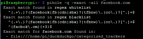

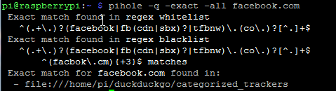

Would it be possible to change the output, to match the output of pihole -q -exact, e.g.
pihole -q -exact facebook.com
 Exact match found in regex whitelist
   (\.|^)facebook\.com$
   ^(.+\.)?(facebook|fb(cdn|sbx)?|tfbnw)\.[^.]+$
 Exact match found in regex blacklist

already using the database schema, that allows duplicate whitelist / blacklist entries, hence, the duplicate entries in the above output of pihole -q
/edit

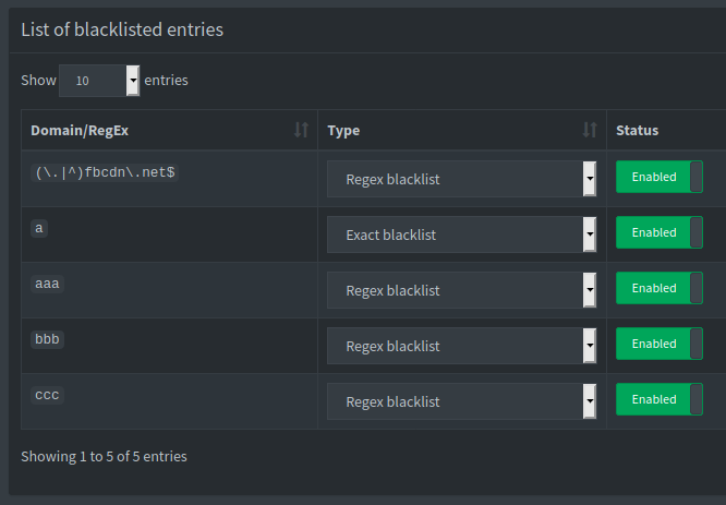

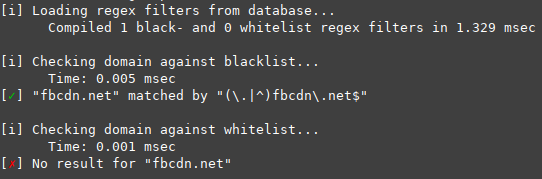

pihole-FTL regex-test "fbcdn.net"
edit I also improved the scripting behavior by defining three possible return types (without looking at the output at all):
  • 0 = match
  • 1 = error (cannot read gravity database, specified regex contains error, etc.)
  • 2 = no match

pi@raspberrypi:~ $ pihole-FTL regex-test doubleclk.nt
[i] Loading regex filters from database...
      Compiled 36 black- and 2 whitelist regex filters in 14.998 msec
[i] Checking domain against blacklist...
      Time: 0.271 msec
[βœ“] "doubleclk.nt" matched by "^(doubleclk\.nt){+3}$"
[i] Checking domain against whitelist...
      Time: 0.096 msec
[βœ—] No result for "doubleclk.nt"

result (example - test environment - using database schema that allows duplicate domainlist entries):
pihole -q -all -exact facebook.com
   ^(facbok\.cm){+3}$
 Exact match for facebook.com found in:
  - file:///home/pi/duckduckgo/categorized_trackers
The problem might be agrep, which is not installed by default and doesn't even exist on Raspberry Pi OS (previously called Raspbian).

I just added a "quiet" regex-test mode which can directly be used within pihole -q
pihole-FTL -q regex-test "fbcdn.net"
results in
    (\.|^)fbcdn\.net$ matches (regex blacklist, DB ID 83)
(the matching regex is in bold when this is a terminal)
Does this solve the problem for query.sh?

 pihole-FTL -q regex-test facebook.com "^(facbok\.cm){+3}$"
    ^(facbok\.cm){+3}$ matches
validates the domain name versus a given regex, the output still doesn't blend in the output of pihole -q (extra word matches)

pihole-FTL -q regex-test "aaabbbccc"
    aaa matches (regex blacklist, DB ID 90)
    bbb matches (regex blacklist, DB ID 91)
    ccc matches (regex blacklist, DB ID 92)
Validating something against a single user-provided regex was never possible in pihole -q. So I don't really see what you want to say here.

the output looks like this (extra indentation before the regex with Approximative matching):
When using this (using the pihole-FTL exit code) in /opt/pihole/query.sh
"regex" )
    for list in ${lists}; do
        if [[ "${domain}" =~ ${list} ]]; then
            printf "%b\n" "${list}";
        else
            if /usr/bin/pihole-FTL regex-test "${domain}" "${list}" >/dev/null 2>&1; then
            fi
        fi
    done;;
the output is properly aligned:
