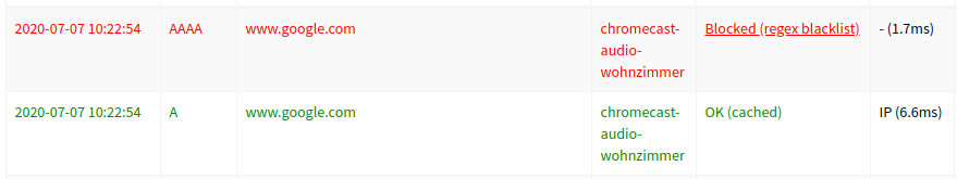

installed FTL (pihole checkout ftl new/tre-regex).
works apparently A and AAAA...

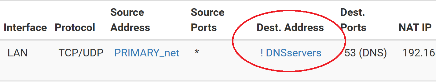

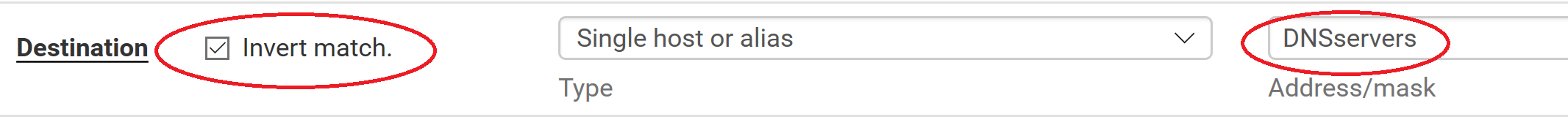

Most firewalls have a solution for this dilemma, simply specify the clients (IPs) you want to be unaffected by the rule, and invert the selection. The result is all clients (IPs) except the ones listed. It looks like this:
and the result is this:
for pihole, this would mean you assign a limited number of clients (IP's) to a group, invert the selection, thus effectively targeting all clients, except the ones listed.
The above regex example would than target the ! AllowAAAAqueries group, making it a lot more effective in an environment where new clients come and go on a regular bases.

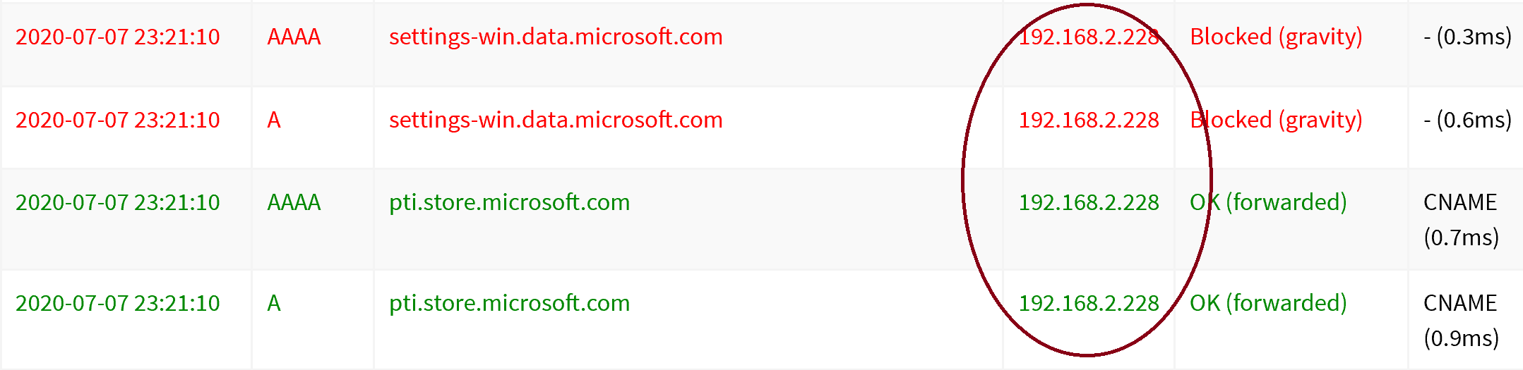

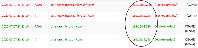

something wrong???
I installed the latest pihole-FTL version (pihole checkout ftl new/tre-regex), the client name doesn't appear to be resolved anymore, only the IP is shown...
I haven't touched any code there, maybe you just have to wait a little longer. If they do not appear, check your /var/log/pihole.log if you see according PTR requests with answers.
correct, problem auto corrected
sorry...
I entered the blacklist regex
^abc$;querytype=a;invert
I expected a correct answer for the A record, no answer for AAAA (or anthing else, however, dig results (what am I missing?):
