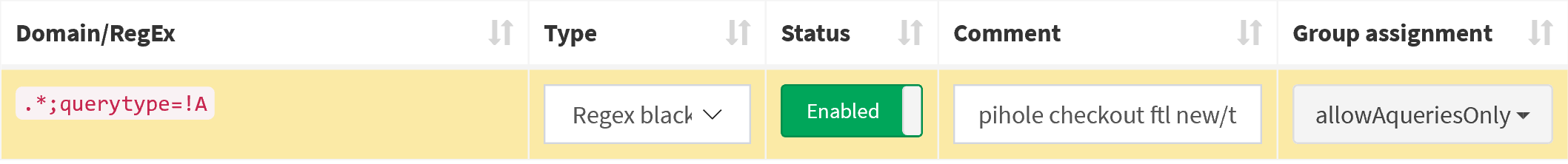

I installed pihole v5.1.1, but now want to continue testing .*;querytype=!A

As expected (see earlier), need to allow PTR queries: .*;querytype=PTR

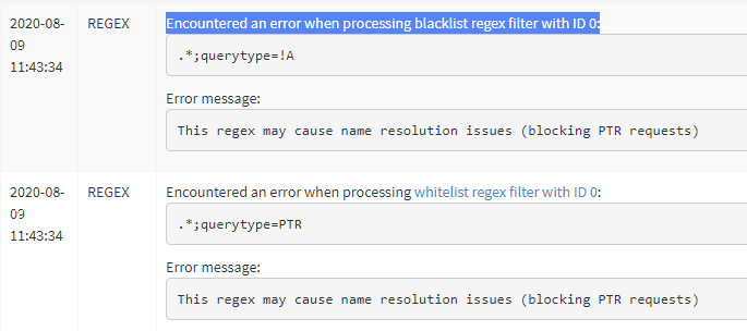

I assume you mean this:
[2020-08-09 11:43:34.781 9052M] REGEX WARNING: Invalid regex blacklist filter ".*;querytype=!A": This regex may cause name resolution issues (blocking PTR requests)
[2020-08-09 11:43:34.806 9052M] REGEX WARNING: Invalid regex whitelist filter ".*;querytype=PTR": This regex may cause name resolution issues (blocking PTR requests)
I've tested immediately,
blacklist regex: .*;querytype=!A
whitelist regex: .*;querytype=PTR
the messages are somewhat confusing:
  • blacklist message: regex isn't invalid, regex might cause network problems...
  • whitelist message: regex isn't invalid, it's a whitelist, so it solves problems...
These warnings are also visible on the tools / Pi-hole diagnosis screen:
Encountered an error when processing blacklist regex filter with ID 0:
It's NOT an ERROR, the regex compiles OK, it should be a WARNING...
I know, all of this is cosmetic, everything works as expected, but it may cause other users to report a problem...
edit
the ID on the Pi-hole diagnosis screen is wrong
/edit
Hmm, yes, maybe it would be better to not include the warning at all. When regex are compiled, we cannot know if there is another regex coming later which is "fixing" this. I also thought about that users may intentionally want to do this (block PTR requests) and they don't want to see such a warning.
Probably better to undo this, there is also the option ;invert which is not really covered here.
As always, thanks for testing, I'm more and more feeling we should revert this. The complexity of getting all the possible negations does not seem to be justified given that this is unproblematic - users will still see the regex link showing them why the PTRs have been blocked.
