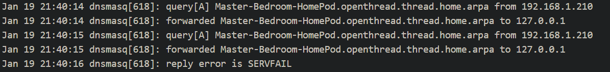

i too have this issue, i believe its the thread network trying to communicate with other thread devices i.e homepod to eve lswitch. PiHole looks to be blocking this and i cant work out how to allow it.

From your screen shot, Pi-hole is not blocking this. The query was forwarded to your upstream DNS resolver, which was unable to resolve it.

Same problem with me. I have several HomePod Minis. They spam my network with requests. SERVFAIL as response. Is there no reasonable solution here, it must be virtually all users with newer Apple devices affected. The behavior seems to occur as of iOS 15.2.
They aren't spamming your network. This appears to be normal traffic for the HomePod devices. I don't see any of these queries with any of my Apple devices, but I don't have HomePods.

I still don't understand the point (of Apple). Queries are made on the network every minute. All of which receive no meaningful answers (servfail). And that is normal (on the part of Apple). Pihole of course works as it should. I would only have hoped that one can put a stop to the behavior. A correct answer would be nice (IP, not servfail). 15.3 has still endless queries.
