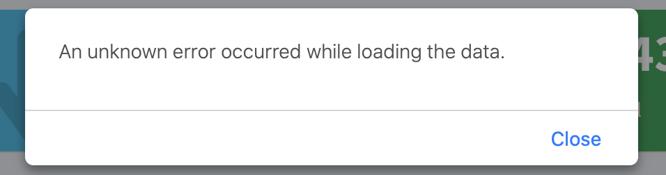

Querying long term data failed due to limited allowed memory for PHP resulting in "An unknown error occurred with loading the data"

I am not sure if this is a problem or if it's by design. Maybe a better error message is required if that's the case. Under Long Term Data menu, you have three options to search by. Graphics, Query Log, and Top Lists. In Graphics if you choose a time frame longer than your PI has data for. It still displays a chart that just ends sooner based on the data in the database. On the other two options if you perform the same action you get an error "An unknown error occurred with loading the data". My initial reaction was I should have received that same result as the graphics menu, but again if I am wrong maybe change the error so the end-user understands this is because of a lack of data for the chosen lookup period. The way it is now implies a problem with the system.

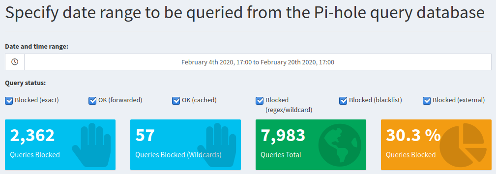

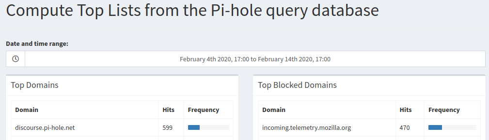

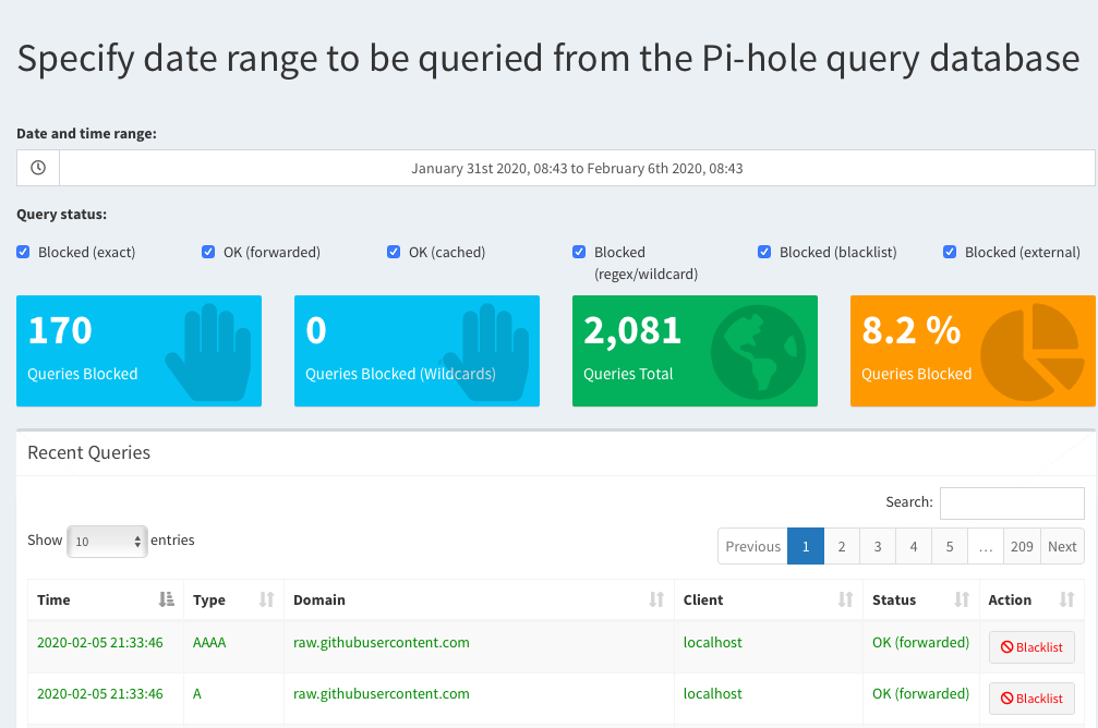

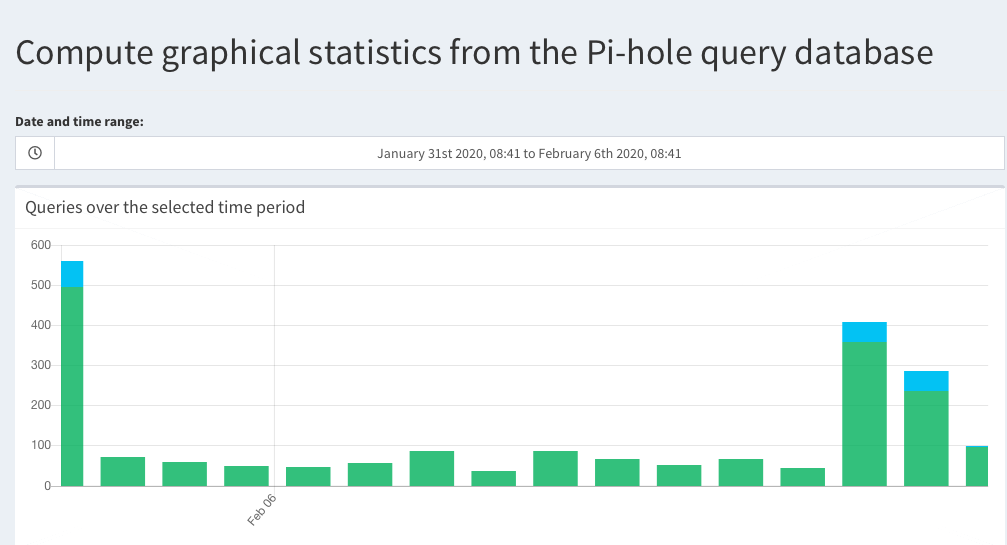

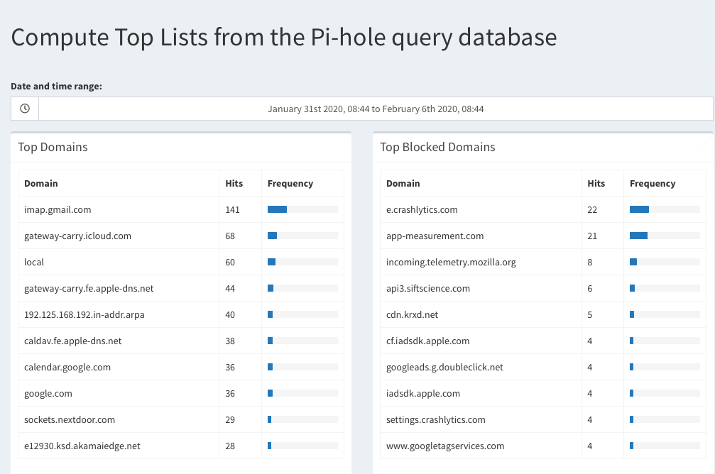

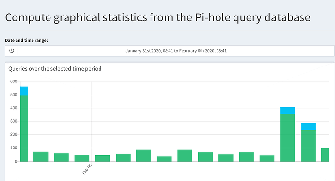

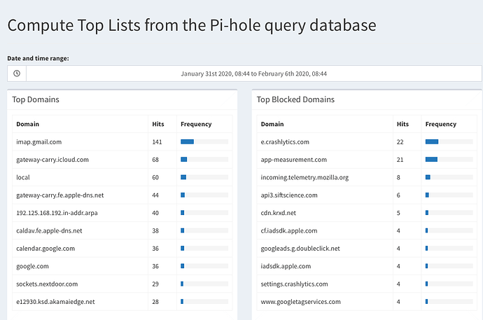

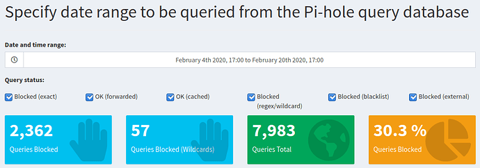

I have a 12 hour old fresh install of Pi-Hole 5.0 beta, and here is what I see on these screens (does not match what you see). In each case, I selected "Last 7 days" from the date and time range. So, it is not by design.
Check.
I ran a query from the day before yesterday to some day next week or even the week after. I see no errors.
everyone I ran an update on my pihole and tried again. I am now able to chose any time frame for Graphics and Top Lists. I still get the error on Query log, even though I am choosing 7 days and I have 6 days worth of data. Not sure what is so unique about my configuration.
How long does it take until the message comes up? Maybe you're simply running out of maximum allowed processing time for the script. Please check /var/log/lighttpd/error.log for any error messages.
Can you please confirm that path. Also the error pops up in less that 5 seconds. Doesn’t feel like a time out.

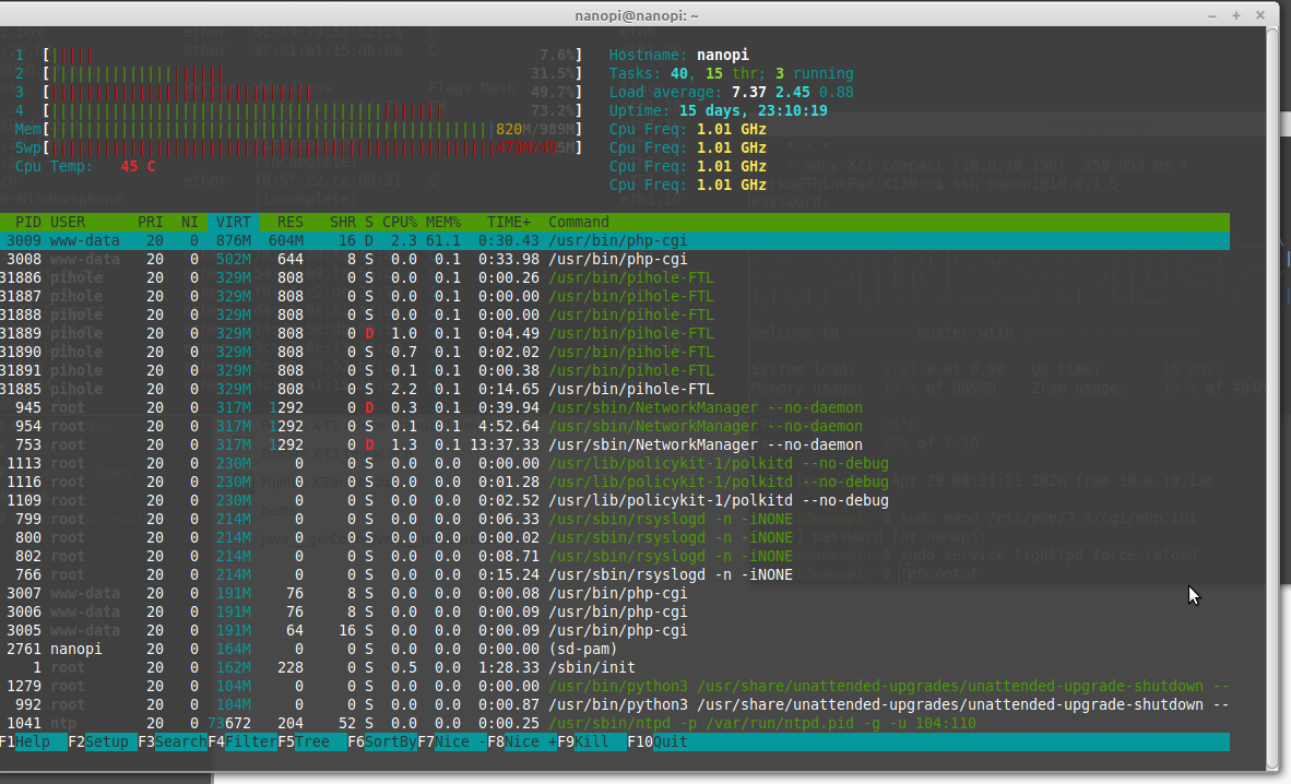

It worked for "this year" (1.3M queries) but the device got total unresponsive querying "all time". It run out of memory, out of swap and pihole didn't resolve DNS anymore. I hard resetted it after a few minutes.
I would not recommend to set it to -1.
Works fine for the nanopi neo LTS that I'm running on. 512M Ram/256M swap.
