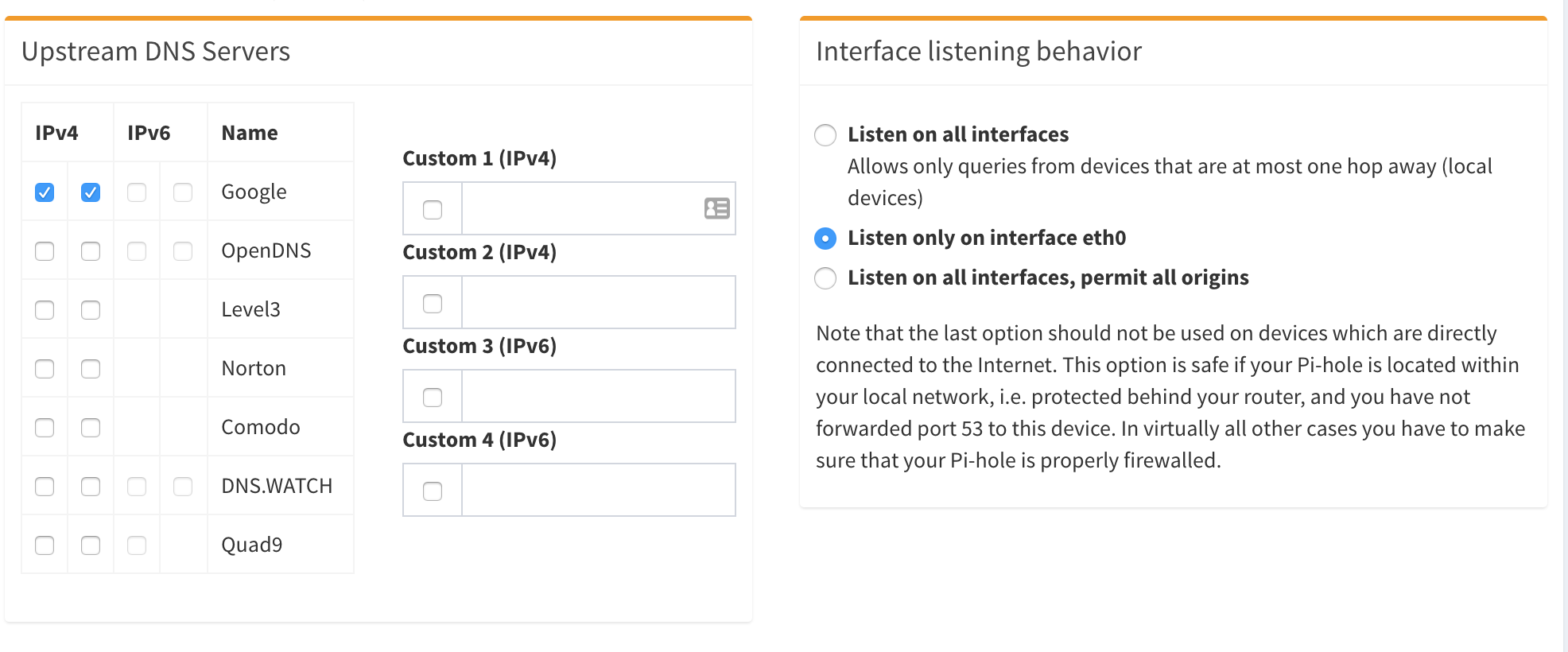

  1. In my Pi-Hole Config have the following DNS config
Setup seems to be working. I can see traffic on Pi-Hole interface and blocks etc..

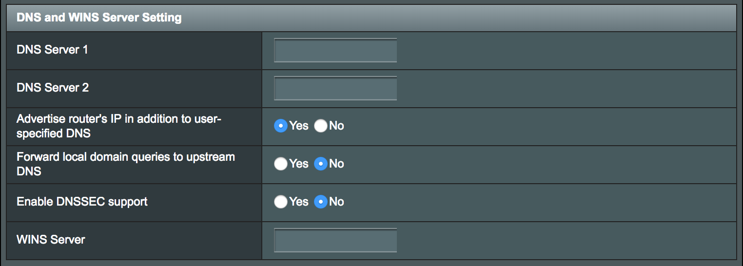

  1. Is the setup correct? I believe some value should be there in the router DNS Server 1 and DNS Server 2?
  2. Is the redirect via the dnsmasq.conf.add file correct or needs to be something better?

In your router's settings, why don't you just set the DNS1 to Pi-hole's DNS, disable the "advertise router's IP in addition to user-specified DNS" option, and remove the extra dnsmasq dhcp option?
