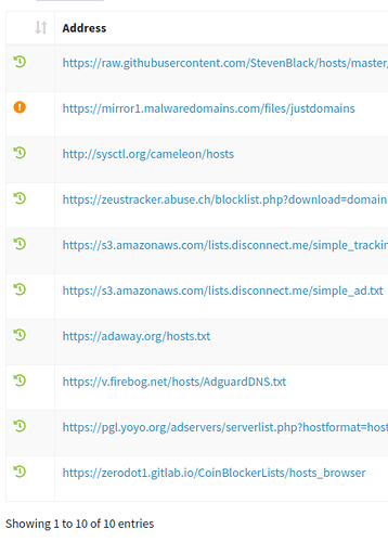

Since v5.0 pihole displays a mouseover tooltip for each adlist in group management containing information about "Last modified" (field date_modified in gravity.db).
From a user's perspective I would expect this date corresponds to the date the content of the adlist has changed. Instead, it shows when the database entry for that adlist changed.
This can easily seen by enabling/disabling an adlist and the "Last modified" will change.
