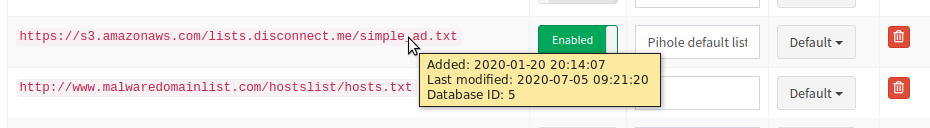

Since v5.0 pihole displays a mouseover tooltip for each adlist in group management containing information about "Last modified" (field date_modified in gravity.db).
From a user's perspective I would expect this date corresponds to the date the content of the adlist has changed. Instead, it shows when the database entry for that adlist changed.

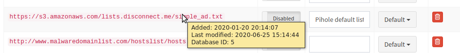

This can easily seen by enabling/disabling an adlist and the "Last modified" will change.
During a gravity run, pihole already reports whether the content of an adlist has changed or not - so the information is already available to pihole .
Bildschirmfoto zu 2020-07-05 11-48-07
I therefor request to change the date_modified in gravity.db only then the content of an adlist has changed and not the database entry.
