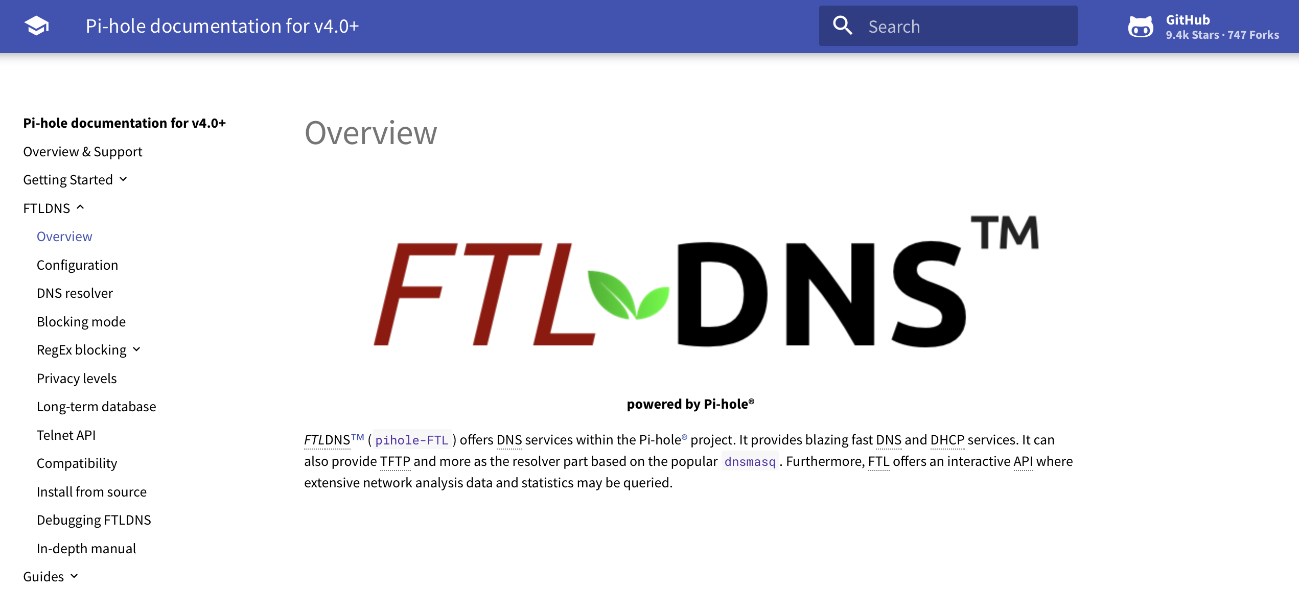

We're very pleased to release Pi-hole v4.0 today, which includes fixes, tweaks, and lots of new stuff, including FTLDNS (special thanks to our beta testers!) In a sentence, FTLDNS is dnsmasq with Pi-hole's special sauce baked in.
FTLDNS does everything dnsmasq does because it is dnsmasq--just our fork of it. So all of your existing config files will still work with it. We intentionally modified the original dnsmasq source code as little as possible so that we can easily integrate any upstream changes as they are released.
Read on to find out everything included in this release or read the technical details in the changelogs.

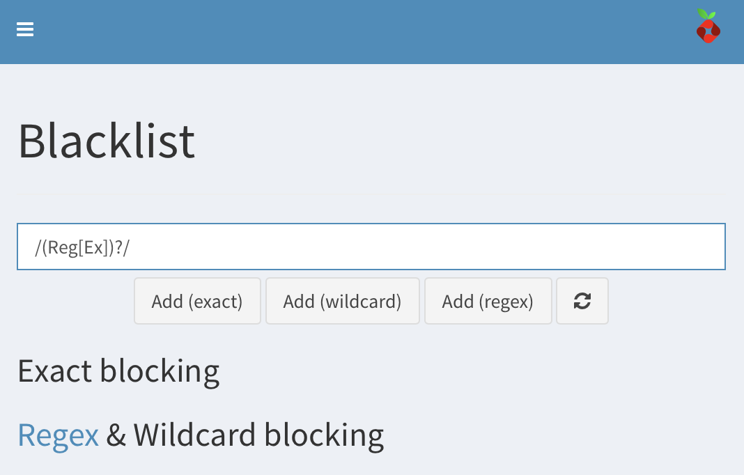

Regex Blocking
We have introduced regex blocking. More details on that can be found on our documentation site. With this feature, you are able to specify an arbitrary amount of arbitrarily complex blocking filters.
The wildcard button is a compatibility wrapper function, which outputs a regex that acts like the old wildcard blocking.

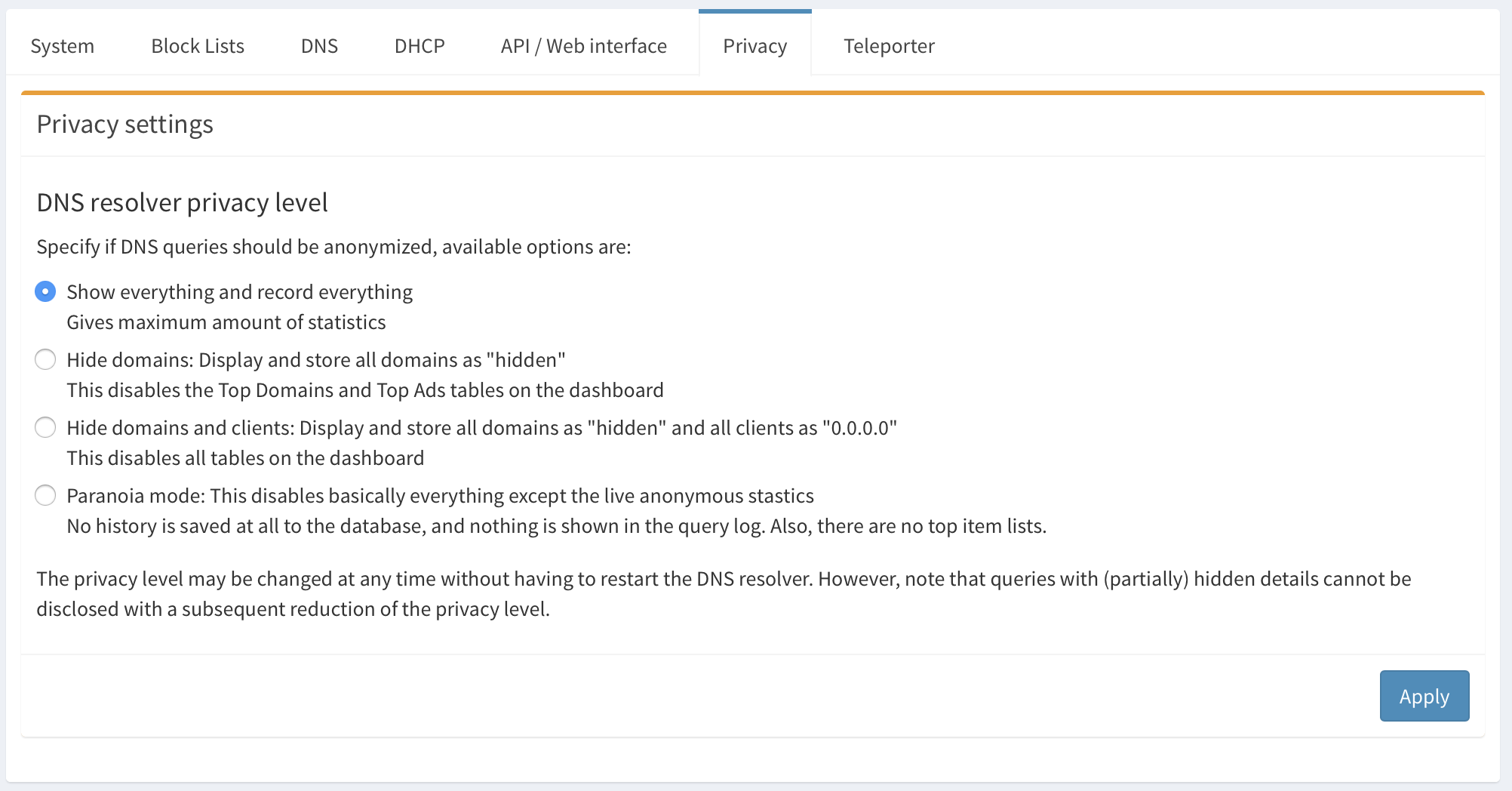

New Privacy Levels
We introduced several different privacy levels, which can be used to fine tune the level of detail displayed in your Pi-hole statistics.

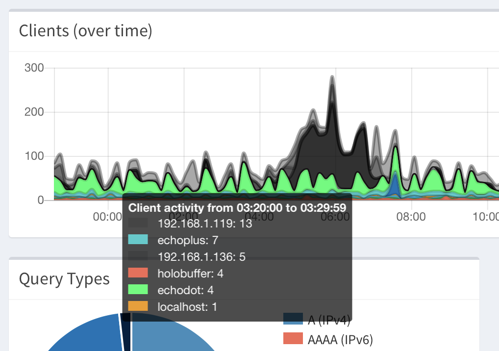

We have fixed several bugs in this release, including the infamous bug of the clients over time graph getting cut off.

Hate to tell you, but the "clients over time graph" is still getting cut off for me (Chrome). I'll play around and see if it works on other OSs/browsers.
I'm running Chrome (latest) on MacOS High Sierra (latest) and the clients pop-over is not cut off for me.
Upgrade from beta to 4.0 on Rpi 2 with no problems.
(followed instructions).
Thank You, Nice job! :slight_smile:
Did you try flushing your browser cache?
Seems to be working as expected in Chrome/Win10. My issue was in Chrome/Android (but that's not always 100% compatible on a good day). I'll continue to troubleshoot.
Following up: Clearing the browser cache solved all of the issues I was seeing in Chrome/Android. Thanks for the help.
