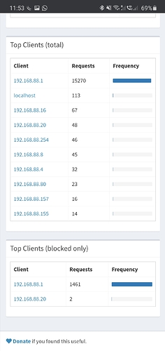

All of my machines are set to directly use the pi-hole device as the DNS server but inside the pi-hole interface I can only see the router as being reported for all of the queries. Plus I also have errors when sending the some dns forwardings to my local active directory, some dns names are not resolved.
https://tricorder.pi-hole.net/uepygnvq72
My DNS server inside the router for the DHCP server is set to the pihole ip, the clients report that they use pihole based on the ip. I have had this issue, I tried to reinstall the pihole on the raspberry, and I even updated to the beta. The issue is still there.

pi@raspberrypi:~ $ echo ">top-clients >quit" | nc localhost 4711
0 252524 192.168.88.1
1 397 192.168.88.9 raspberrypi
2 342 127.0.0.1 localhost
3 7 192.168.100.62
4 3 192.168.100.56
5 1 ::1 localhost
6 1 2a02:2f04:c:550a:1390:9ef6:d3f6:3149 raspberrypi
Strangely there is no client shown besides the router and the local pihole. As you can see, my router is set to distribute the pihole as DNS.

Your router might NOT allow (even though you set it up to broadcast the Pi-hole IP as the DNS), DNS relaying, within the local /24 class.
Try a nslookup flurry.com on a client.
See what it returns.
Also look for anything DNS rebind protection related within the router interface.

Works without problems, just the reporting that apparently is not going right.
