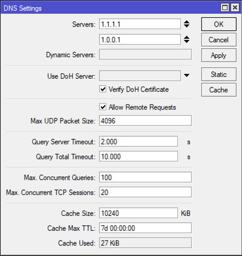

From the screenshot you posted, it looks like your router is handling/issuing most of those DNS requests.
I believe it takes over (as stated above) the DNS requests in an effort to prevent DNS hijacking within the local network.

I don't know how the router would issue the dns requests as the DNS settings inside the router(for the internal dns server) are not even send to direct them to pihole. I am 100% sure the DHCP server is set to propagate the pi-hole DNS server to all the devices in the network. The pi-hole functionality is perfect. Everything worked perfectly until about 2-3 weeks ago when all of a sudden the report regarding DNS requests was full of request from the router IP rather than individual IPs.
I am not familiarized with this interface (can't recognize it) at all.
Is that the DHCP server setting for DNS ?
Is it an ISP provided device ?

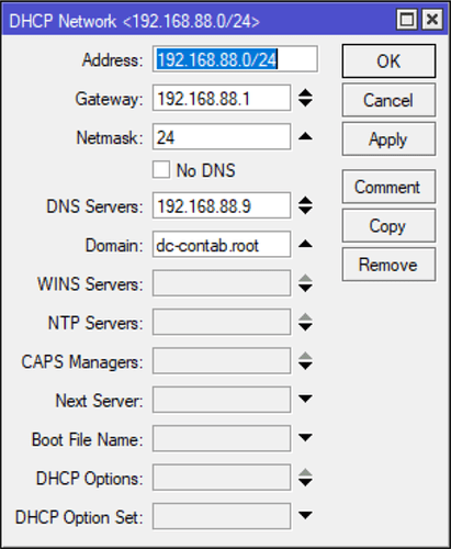

Not at all, it's not a ISP device. It's a Mikrotik router. That screenshot is for the DNS server inside the router.
This are the settings for the DHCP. 192.168.88.9 is the IP for the Raspberry PI.

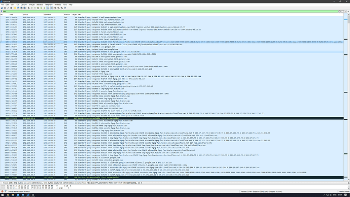

Are you comfortable with throwing a protocol analyzer on the network segment? Wireshark or tcpdump to get some packets and see the source/destination IPs in the packets?

You have the wireshark dns capture attached.
