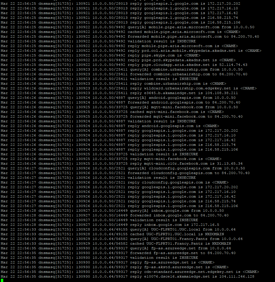

When I run tail -f /var/log/pihole.log I can see all of my devices querying the DNS server.

I manually configured my laptop to use pihole and can see that IP along with all my other devices when I run tail -f /var/log/pihole.log.

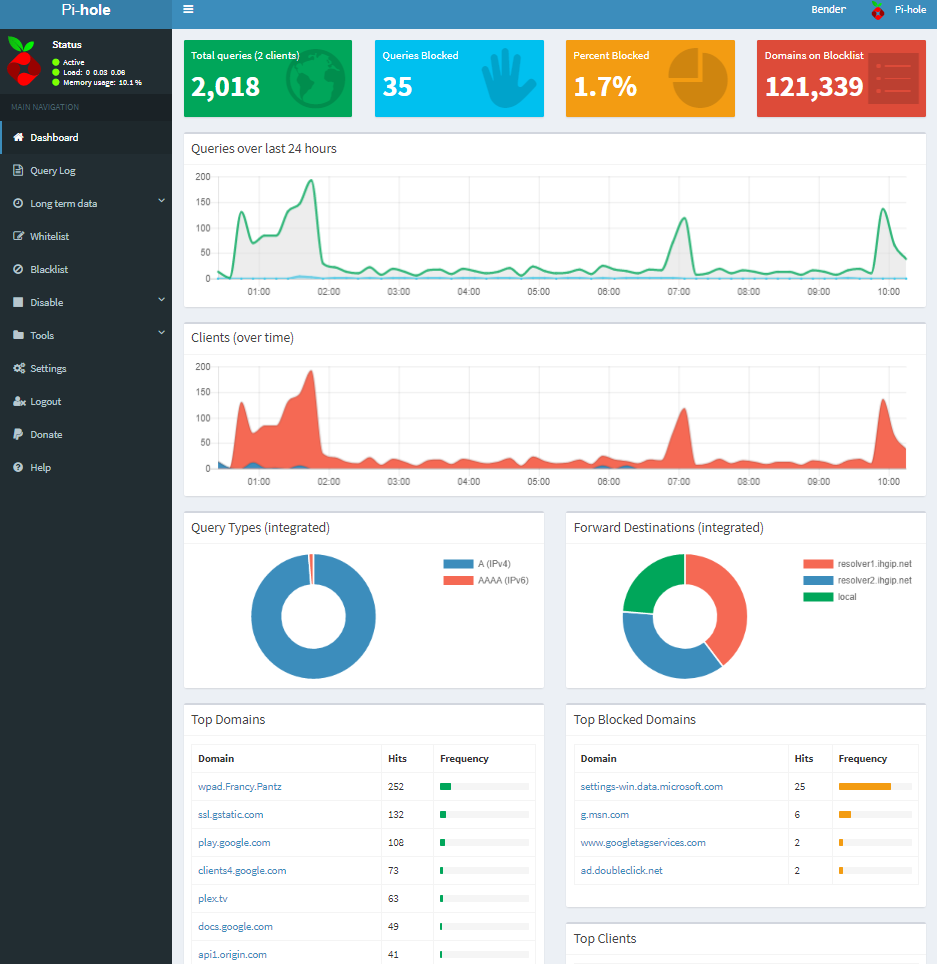

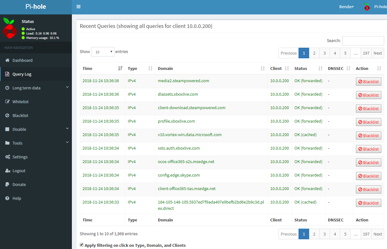

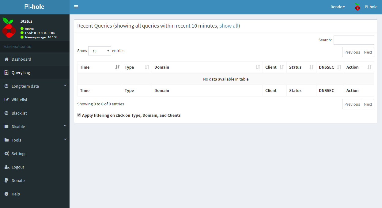

So Pi-hole is working, you just don't see all the clients on your dashboard? Can you post a screenshot?
Here are some screenshots of the dashboard and query pages. I also included a tail -f /var/log/pihole.log showing several other clients.

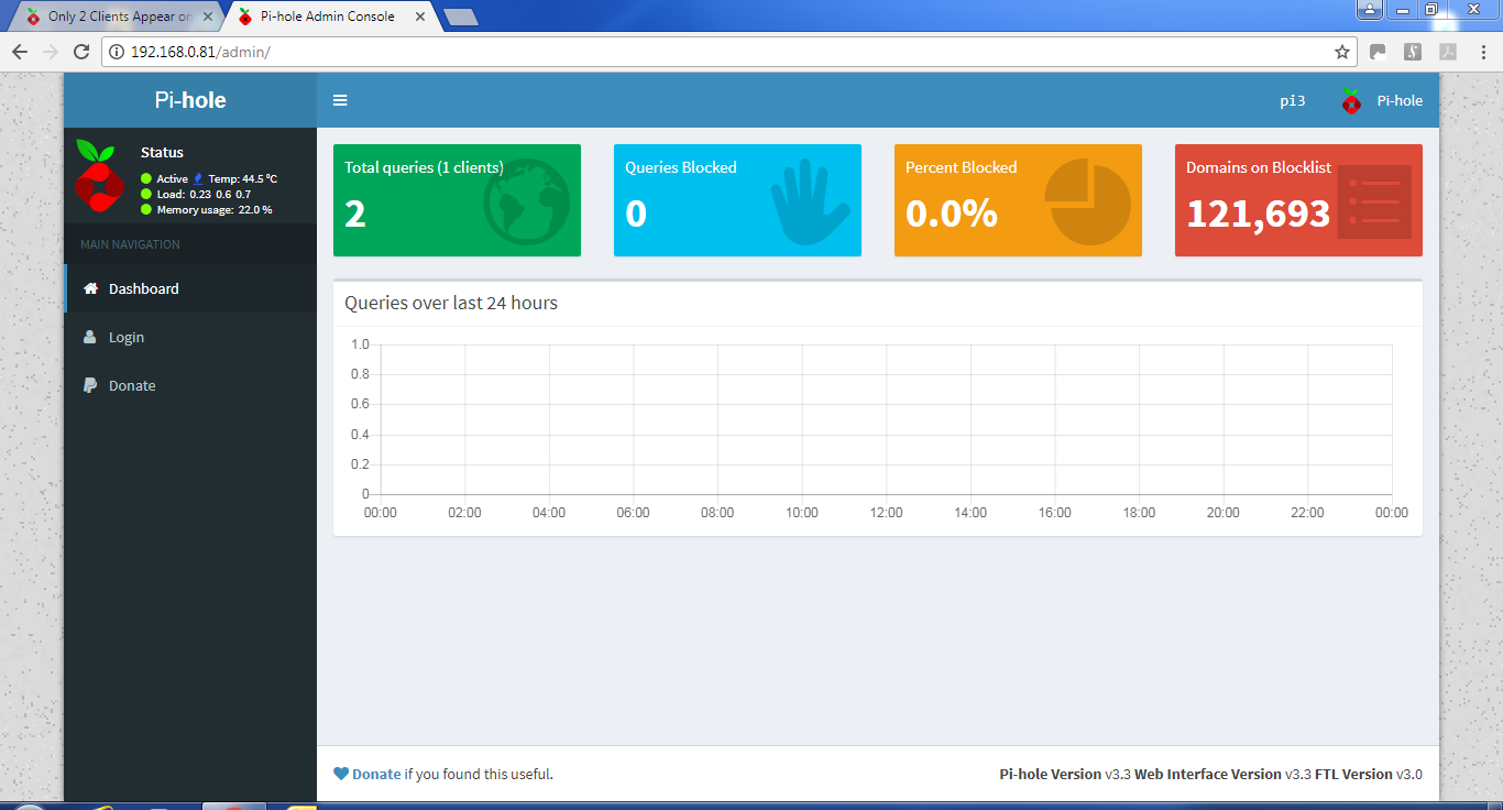

Hello, I am having the same problem with the pi-hole stats and dashboard only showing 1 client and 2 queries?
System : Rasp Pi 3 running Stretch latest updates applied
I reinstalled pi-hole which sorted the problem but it returned.
Now I have done a pi-hole repair and debug TOKEN : 8moqx22v0n

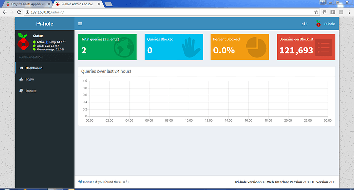

Sorry too quick for my own good, the problem has recurred so the python script does not seem to be the culprit. Everything was working OK while I had the pi-hole dashboard running in my browser. I closed the browser down went for a coffee, started browser and dashboard again and lo and behold same problem!!
What I have noticed is that it is always the same top domain.
Hostname: pi3 (Raspberry Pi 3, Model B)
Uptime: 00:43:33 (UV, TT)
Task Load: 0.65 1.21 1.16 (Active: 8 of 92 tasks)
CPU usage: 13% (4x 1.2 GHz @ 318k)
RAM usage: 38% (Used: 355 MB of 927 MB)
HDD usage: 13% (Used: 7 GB of 58 GB)
LAN addr: 192.168.0.81 (Gateway: 192.168.0.1)
Pi-hole: Active (Blocking: 121693 sites)
Ads Today: 0% (Total: 0 of 2)
Local Qrys: 100% (4 DNS servers)
Blocked:
Top Advert:
Top Domain: 3.debian.pool.ntp.org
Top Client: localhost
I think it is the NTP service that is somehow causing this problem, maybe you can see @FredsFred if it is the same for you?
