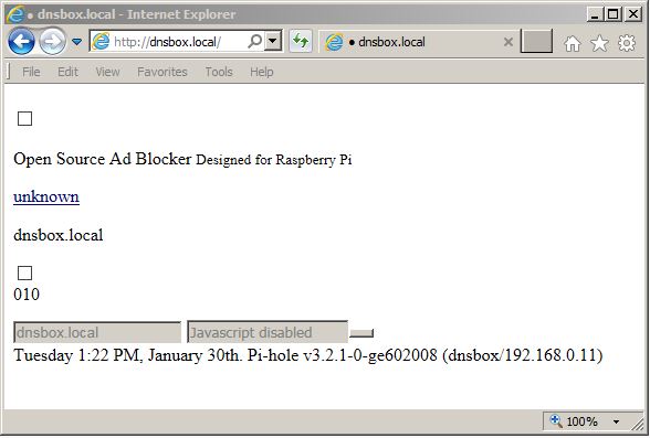

No access to admin page after PiHole installation
I followed exactly these intructions this morning on a native OS install that went along very smooth - no error messages.

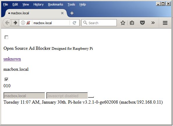

The services just started fine from what I could follow from the installation process, and then with any of my web browers, I'm getting this picture
and this picture
The same after rebooting the deivces :roll_eyes:
I used as OS the latest Raspbian Stretch image of November 2017.
I've tried the installation of Pi-Hole on the lite and on a full OS image, however no luck, and am digging mysefll through this forums and other posts to figure out on how to troubleshoot further :frowning:
It looks like you have JavaScript disabled, and the CSS can't load. Can you reach the web interface? http://pi.hole/admin
Thank you for the suggestion, and I can confirm that my browserx have JavaScript enabled.
I've tested this with an online tool "How to enable JavaScript in your browser", and it confirms that my browser is indeed JavaScript enabled
Based on other discussions found with "How to detect whether CSS enabled or not using Javascript", I can also conclude that my browsers support the CSS.presentation.
Concluding, my browsers setup ought to be fine, otherwise I would see the same symptoms when accessing other web portals...

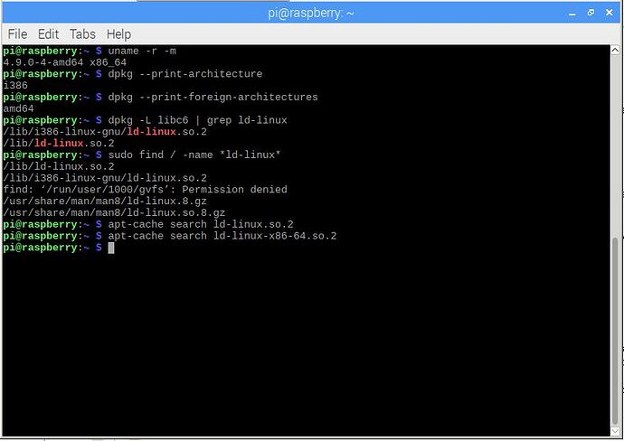

Following the exchanges on another post, further info can be provided.
Output of "strings /usr/bin/pihole-FTL | head":
/lib64/ld-linux-x86-64.so.2
Output of "dpkg -S ld-linux-x86-64.so.2":
dpkg-query: no path found matching pattern *ld-linux-x86-64.so.2*
Output of "stat ld-linux-x86-64.so.2":
stat: cannot stat 'ld-linux-x86-64.so.2': No such file or directory
Output of "whereis ld-linux-x86-64.so.2":
ld-linux-x86-64.so.2:
Thus, from above steps, to me it looks like a library is missing...

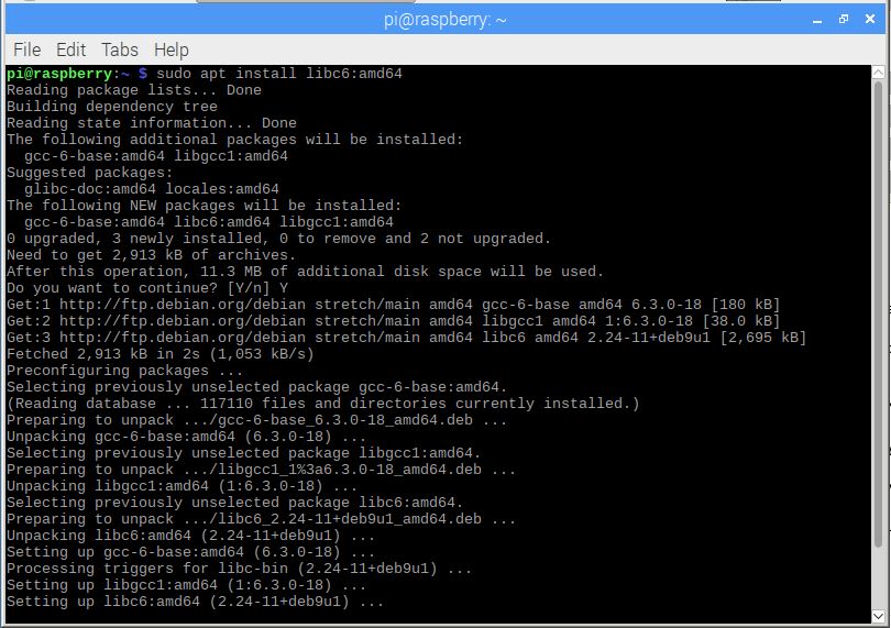

However, when firing the command "sudo apt-get install libc6" as suggested with another post, I'm getting the following output:
Reading package lists... Done
Building dependency tree
libc6 is already the newest version (2.24-11+deb9u1).
0 upgraded, 0 newly installed, 0 to remove and 2 not upgraded.
I've done further queries on the Debian 9.x platform as per another post, and share the results as depicted with:
That is how to install the 32 bit "libc6" package.
If you run the 64 bit "pihole-FTL" binary (file /usr/bin/pihole-FTL) , on a 32 bit distro (dpkg --print-architecture), with a 64 bit kernel (uname -r) , on 64 bit capable hardware (uname -m), it will need the 64 bit version of that "libc6" package.
You could try to install the 64 bits version of that package with below one:
sudo apt install libc6:amd64

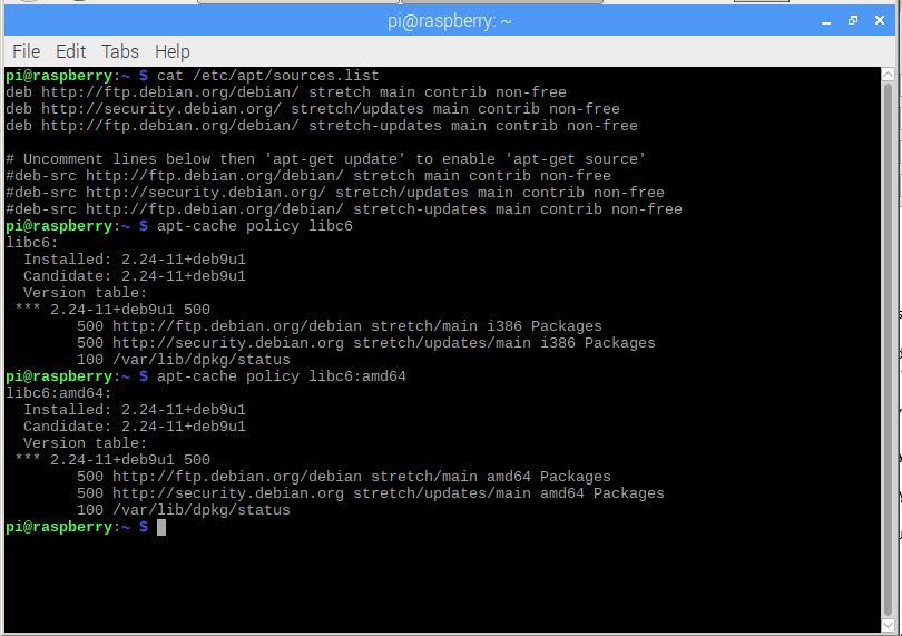

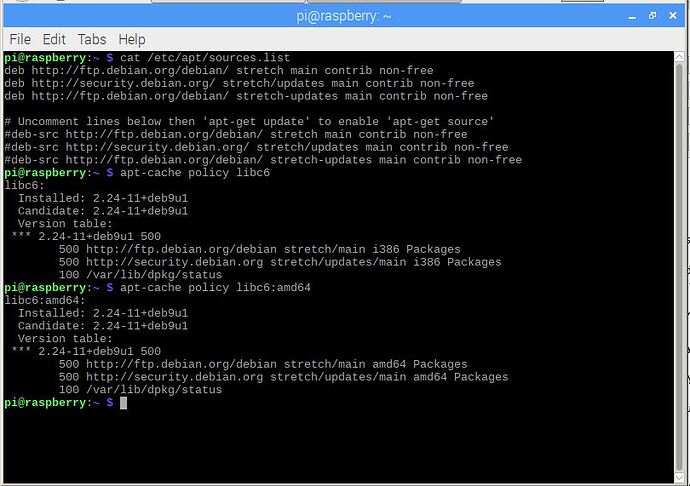

What do you have now in "/etc/apt/sources.list" ?
EDIT: Am curious now which distro is mixing 32 with 64 bits out of the box.
Which distro did you install ? Do you have a download link ?
EDIT2: Owh and whats outcome for below ones ?
apt-cache policy libc6
apt-cache policy libc6:amd64

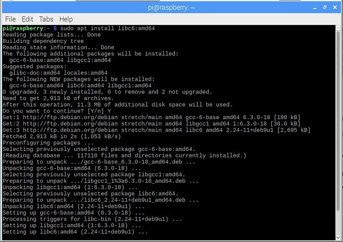

Here the answers as requested, I have manually installed the libc6:amd64 package as depicted with:
The distribution is a native Debian Stretch 9.x Linux OS taylored for use with Raspberry Pi deskop. You can download its DVD Image file with this hypertext download link.
The OS packages update policy is as depicted:
Anything else I need to provide, or are we good to try the re-installation of PiHole?

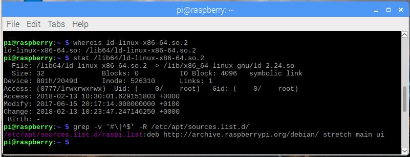

Check if that missing 64 bits library is installed now before go ahead and try install again:
stat /lib64/ld-linux-x86-64.so.2
But I wouldnt have installed this "Debian Stretch with Raspberry Pi Desktop" on an Intel/AMD machine except maybe if your a developer for Raspberry Pi things.
I would have installed the regular Debian stretch distro ... a pure 64 bits version.
And without a desktop if you dont need it.
EDIT: Ohw thanx btw for the extended info!
EDIT2: Forgot to ask, anything in this folder ?
grep -v '#\|^$' -R /etc/apt/sources.list.d/
Here the requested information as depicted with:
And I will now go eahed and try the installation from scratch based on the outlines and learnings from previous posts.
I have reinstalled Raspberry Pi deskop (Debian Stretch Linux for the Intel platform) from its DVD Image on an Intel based platform recognised as x86_64 (output of "uname -r") and i386 (output of "dpkg --print-architecture") architecture.
Have updated the OS with the usual "sudo apt-get update ; sudo apt-get -y upgrade" commands and, right after, manually installed the libc6:amd64 package with the command "sudo apt install libc6:amd64".
After all that, I fired the PiHole installation process with the known commands, and everything just worked fine - the installation process ran smooth - no errors; the UNIX processes are all running fine upon installation completion including the intially failed pihole-FTL process.
I now have access to the admin page after its installation. :slight_smile:
