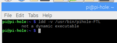

I'd assume it is a binary error. The kernel also says "no such file or directory" when one of the required libraries cannot be found. Please tell us the output of
ldd -v /usr/bin/pihole-FTL
ldd -v /user/bin/pihole-FTL
result: not a valid executable
/usr/... not /user/...
yes sorry - I did enter it correctly in the terminal just not when retyping here.

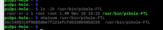

ls -lh /usr/bin/pihole-FTL
sha1sum /usr/bin/pihole-FTL
In troubleshooting before the rebuild I tried modifying the permissions on pihole-FTL to: chmod 777
-Didnt make a difference I believe.
Assuming there may be something strange with this file should I try obtaining one manually and overwriting this one?

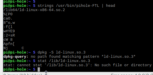

pi@noads:~ $ strings /usr/bin/pihole-FTL | head
/lib/ld-linux.so.3
pi@noads:~ $ dpkg -S ld-linux.so.3
libc6:armhf: /lib/arm-linux-gnueabihf/ld-linux.so.3
pi@noads:~ $ stat /lib/ld-linux.so.3
  File: โ€˜/lib/ld-linux.so.3โ€™ -> โ€˜/lib/ld-linux-armhf.so.3โ€™
Does that library "/lib/ld-linux.so.3" exist on your distro ?
Hope I entered these correctly. Looks like I don't have ld-linux.so.3

Try these three:
So the library that pihole-FTL depends on is "/lib64/ld-linux-x86-64.so.2".
Is it installed ?

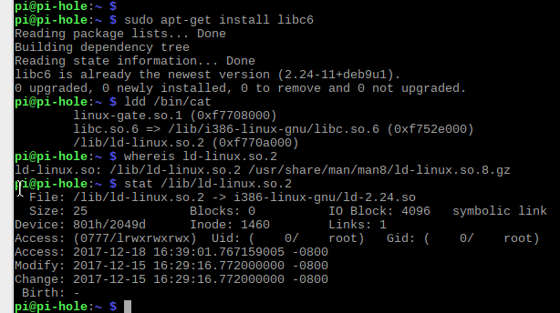

dpkg -S ld-linux-x86-64.so.2
And is it at the expected location ?
whereis ld-linux-x86-64.so.2
stat /lib64/ld-linux-x86-64.so.2
That library is part of the "libc6" package.
If not installed, you can do so with below one:
sudo apt-get install libc6
And check again if that library is at expected location now with the "whereis" and "stat" commands.
Thank you for the help narrowing this issue down.
Running dpkg, whereis, & stat all resulted in 'no results'. I ran apt-get for the libc6 package and it reported I already had the latest version installed.
I found another command (ldd) that pointed toward a similarly named library ld-linux.so.2 located in /lib/. Could this be what we're looking for?
Dont need to lookup dependencies for the "cat" command.
Its the library "ld-linux-x86-64.so.2", the 64 bits version, what the pi-hole-FTL binary wants.

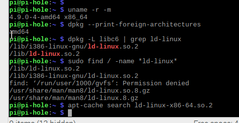

Could you post results for below ones ?
uname -r -m
dpkg --print-architecture
dpkg --print-foreign-architectures
dpkg -L libc6 | grep ld-linux
sudo find / -name *ld-linux*
apt-cache search ld-linux-x86-64.so.2
EDIT: Mind I altered the find command.
Sorry for the irrelevant tangent. Here are the results of the commands

Am not sure if you can run binaries intended for a 64 bit system on a 32 bit (i386) distro but dont think so.
What distro did you install and did you add that foreign architecture "amd64" and what for ?
Dont know if a 32 bit pi-hole-FTL version exists.
If its a fresh install, you could try re-install on the 64 bit version of that distro.
Maybe the @developers can shed some light ?
There are 32 bit binaries available: Release FTL v2.12 ยท pi-hole/FTL ยท GitHub
