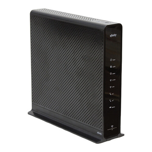

Infinity is not a router brand. Would you please provide the make & model of this router so that we can help you with where the DNS settings would be. Right now, I would suspect that it may be located in the Advanced area.
@Tesserax
I assumed Comcast set up a unified browser interface for all customers regardless of what specific unit they used. (Or had custom things enabled/disabled)
In any case, it's an Arris TG1682G

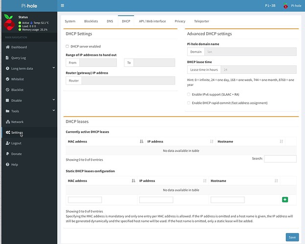

How do I get that nice GUI interface that I saw some of the tutorials show with the checkbox for DHCP for the pihole?
@Tesserax Unfortunately, there is no such checkbox for the router.
This is on the web admin GUI > settings > DHCP page
@jfb
I mean, I don't know how to open the GUI in the first place. It's not in the applications on the raspberry pi, at least anywhere I can find. I didn't see an argument I could pass to pihole to make it open either.
The GUI is an option that you select to configure at Pi-Hole install. If you run pihole -r and select "reconfigure", it will ask if you want the web admin installed. Say yes.
You may already have it installed and don't know how to access it. From a browser, type
http://pi.hole/admin
See edit above. You have to open the admin page in a browser.
