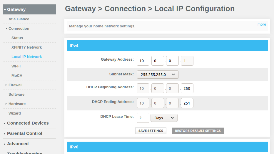

Since my router/modem does not allow me to disable DHCP or set exact IP addresses, I tried to follow all of the instructions in this post and set my DHCP range to only my Pi-hole's IP, but this is where I'm running into problems. I was first given 10.0.0.253 as my IPv4 when I set up my Pi/Pi-hole with WiFi. Then, when I reconfigured for ethernet I set 10.0.0.251 as the Pi-hole's static IP. This worked for a bit, then for a few days "ipconfig" was showing no eth0 IPv4. I was also not able to SSH into my Pi with the .251 address, only the .253. Just now I went through disabling IPv6 then deleting the local.conf file as explained in this comment, which seems to have worked and I'm seeing the 10.0.0.251 IP everywhere now for my Pi and Pi-hole's ethernet address.
So, the problem: on my router's admin page, I have the DHCP range set as 10.0.0.250 - 10.0.0.251, I was attempting to assign my Pi's Ethernet address as my only DHCP server as the post I linked instructed. But under "connected devices" on my router admin page I also see my Apple Watch (S3 w/ cellular) as having the exact same IPv4, 10.0.0.251.

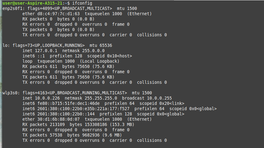

Can I the output of "ipconfig /all" from a windows device? Or "ifconfig" from a linux device?

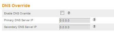

Lastly, what are the DNS settings listed on the Arris gateway?
Unfortunately, buying a new router/modem is not really in consideration at the moment. Bridge mode would only be helpful with another router, correct?
ifconfig on my main Linux machine yields:
The closest thing to DNS settings on the Arris gateway (no option to manually set DNS so I was trying to restrict the DHCP range to use the Pi's IP):

Since you can't switch off your router's DHCP server, limiting its DHCP range to accomodate just Pi-hole is a viable way to allow for a predictable way of coexistence with Pi-hole's DHCP server.
Yet your router's range is allowing for two IPv4 addresses, .250 and .251, so a device snatching the latter would likely by-pass Pi-hole.

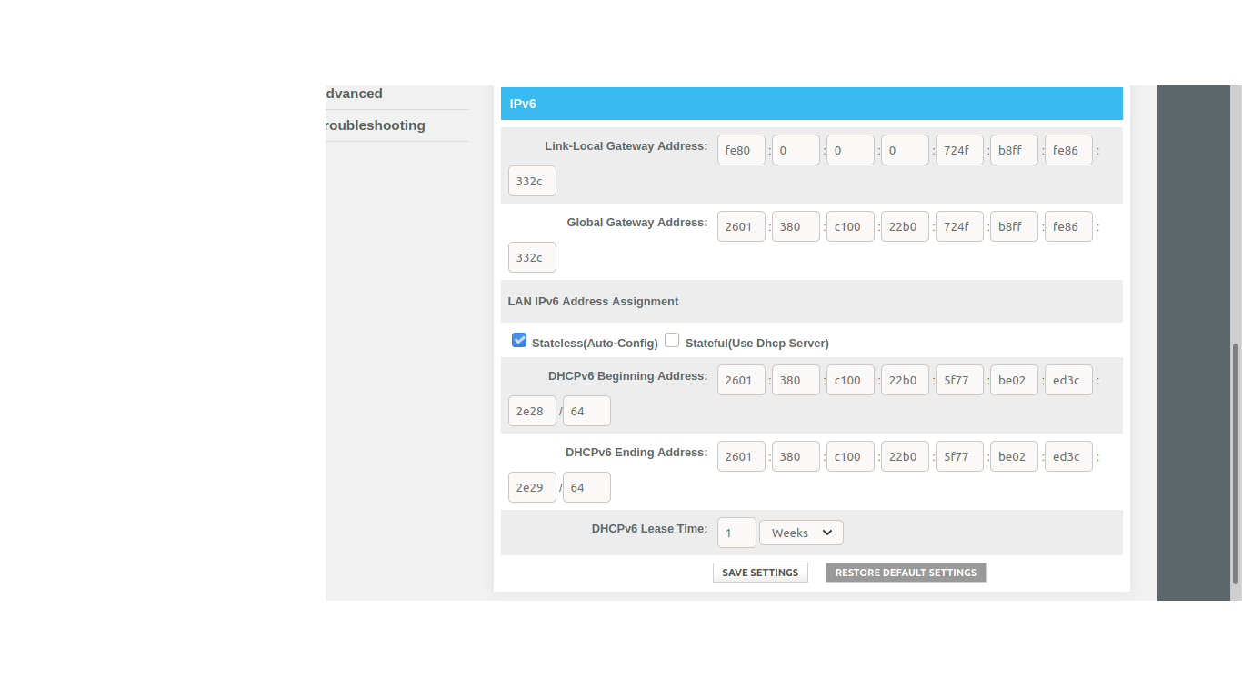

Here are the only IPv6 settings I have:
The range I have set in the lower field was an IPv6 address for my Pi, I was trying to do the same thing as I did with IPv4. So if these are my only options, is there any damage control I can do to reduce the amount of IPv6 traffic going through a different DNS?
I do see IPv6 addresses as clients on my Pi-hole, and currently at least some of that traffic is going through it. Is my best bet just disabling IPv6 on a per-device basis or do you see something in these settings that may help?
