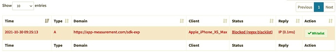

regex working for that is:
(^|.+.|.+)app-measurement.com(.+|$)
For me, it's the case for every https request
This confirms my hypothesis
at least for @yubiuser

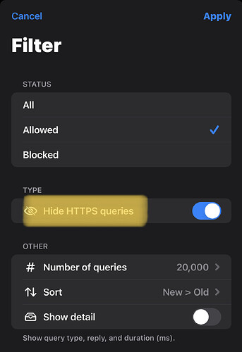

The reason I made it a feature request was if something could be implemented as below.
This is from the Pi-Hole Remote app. It does hide these from the query log when viewing through it.
I'll move it back to a Feature Request. It will accumulate votes like other open feature requests.
This is interesting and also somewhat misleading. As it says "hide HTTPS queries" under the title "TYPE", I'd have expected it to do exactly this: Hide queries with type HTTPS.
However, what you describe is that it hides all queries (also A type ones) when then domain starts in `https://... This is obviously something different. Or does it hide both kinds of queries?
I think that is a misunderstanding:
Pi-hole cannot hide any HTTPS requests, as it never even receives them.
Pi-hole is only receiving DNS requests - in your case, a request for an improper domain name of https://app-measurement.com/sdk-exp. Like any domain, that can be blocked (via they ways already discussed) and/or excluded via Pi-hole's API / Web interface UI.
The true fix for this would be for the app and kit developers to adjust their incorrect DNS requests.
I would not add an specific option to hide the mal-configured https://app-measurement.com/sdk-exp nor HTTPS (TYPE 65) requests. If at all, this feature would need to be way broader:
Since this query type is unique to Apple IOS, my preference would be to not implement this feature request. We don't selectively hide other requests that are unique to other platforms - root server queries from routers, etc.
