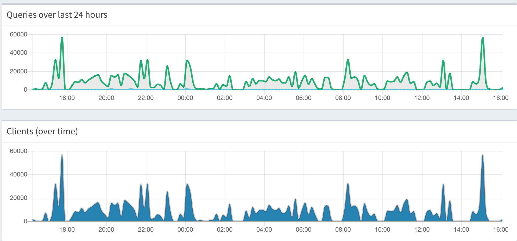

No...Its the strangest thing, I can see on the graph each time it drops out and comes back.
I have the pihole container statically assigned to that IP and running on an unraid server that stays on 24/7. I was just in the UI looking around and got the FTL offline message and lost connection to API and then 30 seconds later its back up and queries are streaming in, and then another minute or so later it falls back offline again.

are you running this Pi-hole for personal home use? That amount of queries looks quite large. To compare, my home network rarely breaks the 1000 threshold on my graphs.
Putting the intermittent service dropping / respawning together with the amount of queries I Think you're running out of shared memory and crashing FTL.
If you aren't expected this amount of traffic you may want to shut it down and secure your firewall / port forwarding.

edit2: I was in the dashboard and saw 5k plus queries stream in within a matter of seconds and then the FTL offline message. I am not expecting traffic like this as diginc mentioned - just a regular home use network. Any thoughts on tracking down the offender(s) ?
