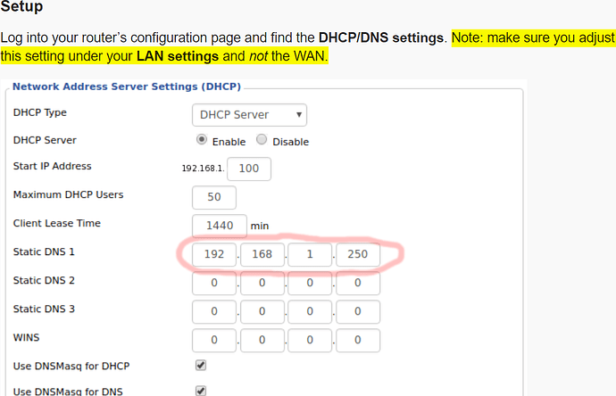

But I am confused as to whether I setup the DNS settings in my router correctly. As per this link from pi-hole documentation I should be changing settings under LAN configuration and not under WAN.

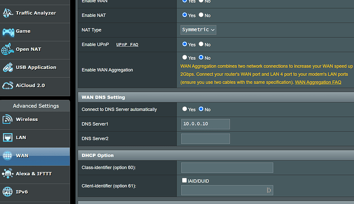

However as per the instructions to change my DNS settings on my router - I am supposed to change the WAN settings and not LAN, which is what I did.
So, question is - did I do it right or should I change the LAN DNS settings as well?

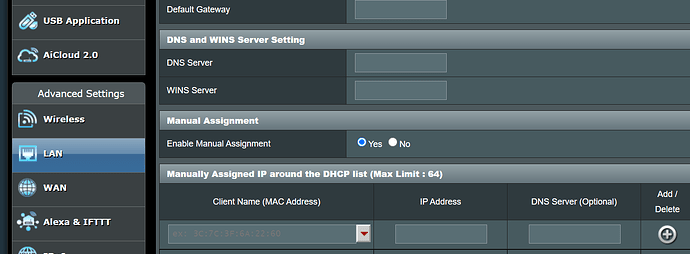

On my ASUS RT-N56U the setting is in LAN then DHCP Server under the DNS and WINS Server setting on that page. The page you show looks similar here on mine so I would think it should be there for you too in your firmware.
The only setting that needs changing is the LAN --> DHCP Server --> DNS Server setting(s).

If you configured your router WAN/Internet DNS setting to point to Pi-hole only, yes this works but you wont see stats described above.
You would only see queries coming from the router.

When have Pi-hole configured in the WAN DNS settings of the router (which is doing DHCP), you dont need CF.

As long as you configured the Pi-hole address as the only DNS server in the WAN/Internet DNS fields!
If you configured a second IP like for example your ISP DNS servers, ad blocking might not work when the router decides to use your ISP DNS thus bypassing Pi-hole.

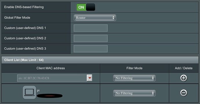

One other setting, when using the Asus-Merlin firmware + Pi-Hole, one should consider enabling is the DNS Filter option. This will supposedly force all LAN clients to go through the Pi-Hole. Go to LAN > DNSFilter, turn Enable DNS-based Filtering to On. Set Global Filter Mode to Router. Leave Custom (user-defined) DNS 1, 2, 3 fields blank. Input/select the Pi-Hole device's MAC address from the Client MAC address drop down box. Next set the Filtering Mode to No Filtering, then select the Add button. When finished hit the Apply button to save the settings.
More on this suggested Asus-Merlin DNSFilter setting change at the following posts/links.
https://www.reddit.com/r/pihole/comments/dfm5j4/guide_for_asuswrtmerlin_users_with_screenshots/
https://www.reddit.com/r/pihole/comments/apfrpz/asus_router_owners_simple_way_to_force_all_dns/
