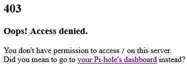

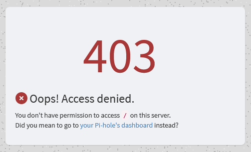

Which ends in a different situation: http://pi-hole.home/ replys with 403 Forbidden, and nearly all script/stylesheet requests (except /admin/vendor/datatables/, /admin/vendor/daterangepicker/ and /admin/vendor/bootstrap-toggle/) return a 301 Moved Permanently to http://pi-hole.home/

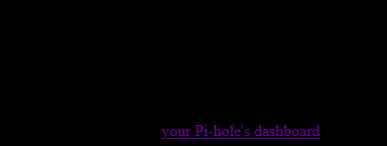

This results in black text on black background:
Which basically wants to tell me:
So how can I get my configuration to work?

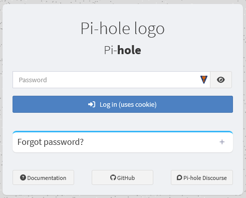

Manually going to http://pi-hole.home/admin/login shows this:
But login doesn't work and http://pi-hole.home/admin/img/logo.svg replys with 301 Moved Permanently http://pi-hole.home/, that's why the logo is missing.
