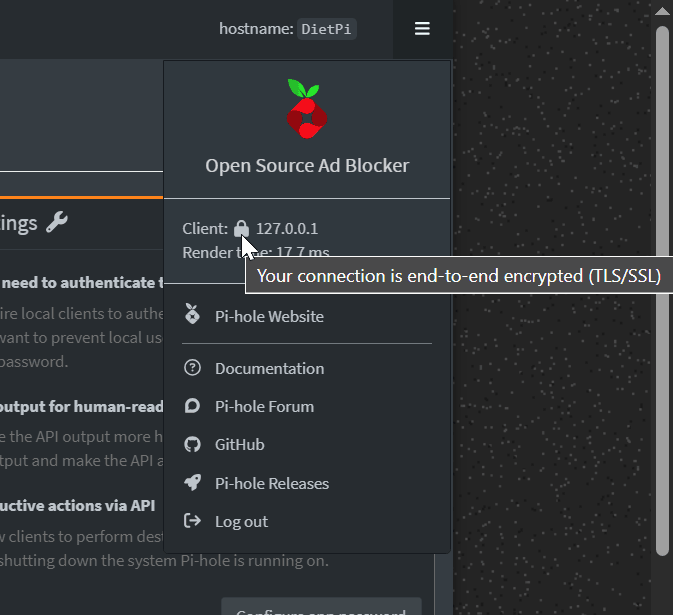

  • with webserver.tls.rev_proxy enabled, the icon on the hamburger menu shows the connention as end-to-end-encrypted.

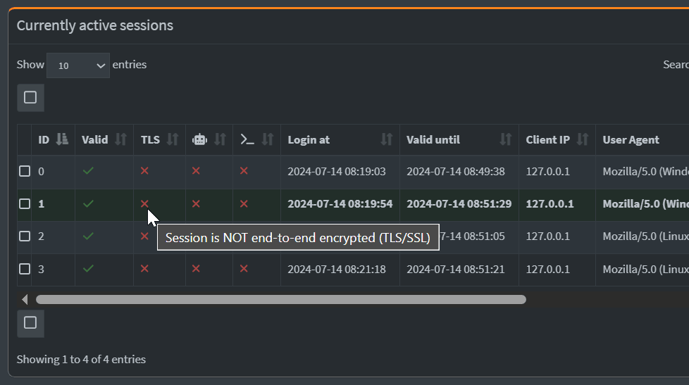

    But the symbol at the Currently active sessions table shows that as NOT end-to-end-encrypted even if the client connects via https.
  • in both the hamburger menu and the Currently active sessions table the Client IP shows up as 127.0.0.1 wich in first place isn't incorrect.

So far, the mentioned setting does nothing more than changing this one icon + tooltip but my argument is that this is actually wrong so, instead of what you hoped for - extending the scope of the setting - I'd actually go the other way and remove this ill-fated config option altogether. There is just no way the application can reliably know if the entire path between the client and server is encrypted in such a configuration. The sessions table is correct at pointing this out.

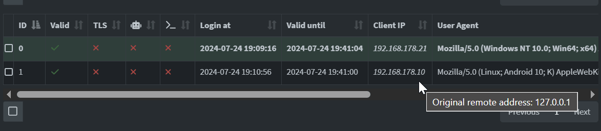

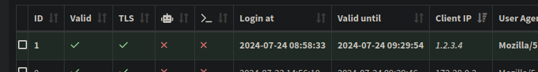

If there is an X-Forwarded-For header, we expect this to be shown as IP address. To signal that something is different, we show the IP address in italics and the "real" remote address in a hover-over tooltip.
edit
Looks perfect in the active sessions table, but the hamburger menu still only shows 127.0.0.1.
What is the idea behind showing the client's IP (and the end-to-end encryption state) in the menu too?
It is a bit more tricky here. We don't use a API call here but instead use a LUA variable during rendering mg.request_info.remote_addr. We need to iterate through the array mg.request_info.http_headers and check for X-Forwarded-For. I pushed this to the branch just now.
So it is available on every page. There are other metrics as well such as the rendering time of the page. This has been requested through the discussion about browsers happily alternating between IPv4 and IPv6. It isn't important at all, just there for the curious.
Works perfectly for me now.
