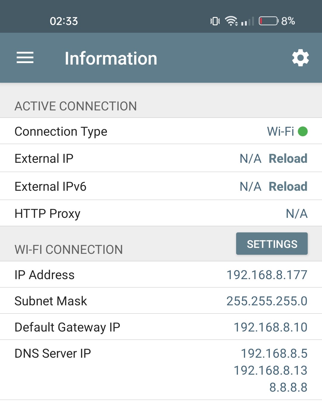

Apart from that, a problem is that stock android smartphones put automatically 8.8.8.8 as secondary DNS (or third) in network wifi config; and I didnot find any way to prevent this.

To check on an Android devices, I advice to install the Network Info app and checkout the WiFi tab.

My phone is a realme, and it does exactly the same : adding 8.8.8.8 as dns at the end.
Do you have the option to advertise two or more IP's for DNS via DHCP?
Validate with that Network Info app I mentioned before.

My router asks a different IP address than the first one for the DNS.
And the misbehaving devices add always 8.8.8.8 as additional dns.
You could try entering 0.0.0.0 for that second DNS address field.
Or enter an unused private IP from your LAN subnet thats outside your DHCP scope.
For the clients it doesnt matter that much if this second DNS IP is dead.

The router is the dhcp server. It has 2 dns fields; primary and secondary.
What dns-server's are displayed when you run below one?
You could disable the router DHCP service and let Pi-hole take over that part:
That way you could try to advertise the Pi-hole IP three times and see if that "Realme" device adds a fourth 8.8.8.8 DNS IP which seems highly unlikely ... but still:
