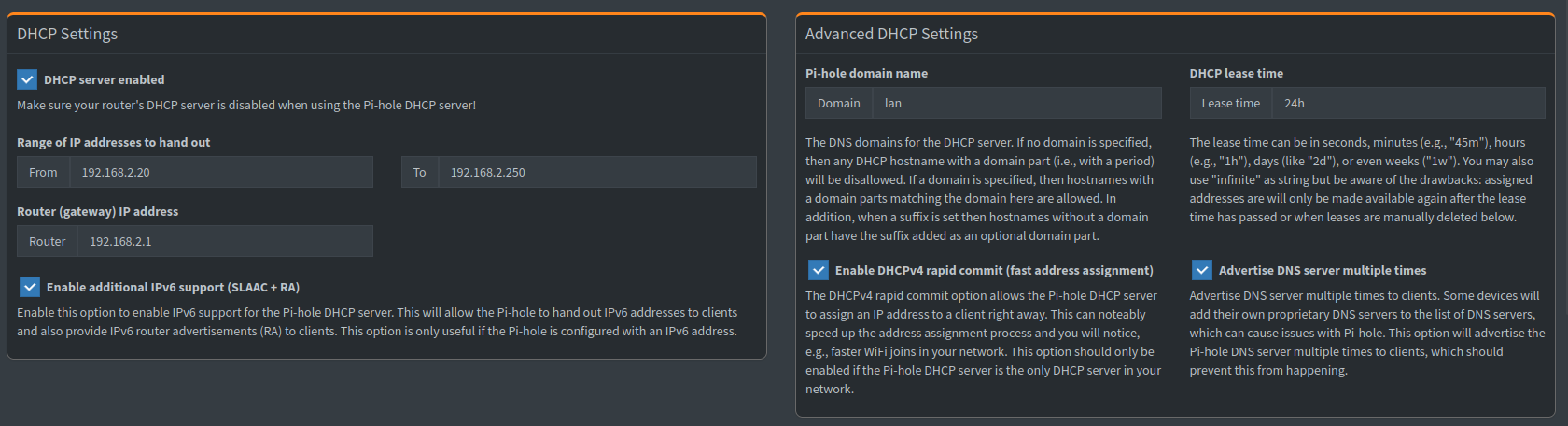

Advertising Pi-hole multiple times through DHCP
I vaguely remember we were talking about an option or even making this the new default for the Pi-hole DHCP server. Do you remember where this discussion happened/what its outcome was? If there was no showstopper I'd be in favor of adding this in Pi-hole v6 as the new default to improve the compatibility with mentioned brands.

Implemented for Pi-hole v6.0 in
https://github.com/pi-hole/FTL/commit/6a199427b43fdc54d4a1ed9fa6d76e08338024e6
A comment about IPv6:
I extended your initial idea to IPv6. It has been implemented such that we will advertise up to six servers. On any machines with IPv6 support enabled, we will advertise the LL addresses twice, when upstream connectivity to the Internet is available, we'll also add the GUA address twice. When the system is properly configured (I consider ULAs as necessary part of a properly configured IPv6 network here), we will even add two ULA addresses. In total this means we have at least four IPv6 addresses being advertised when there is upstream IPv6 connectivity. Probably even six addresses.
