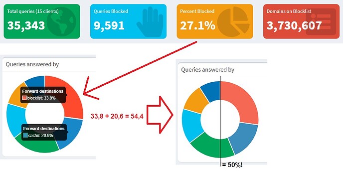

I'm totally new at this board and just installed the pi-hole a week ago. It is working proberly, but I saw some strange behaviour regarding the pie charts in the dashboard and the calculation of them. It does not make sense and is mathematically wrong. My english is not the best, but hopefully you understand what I want to say. So here is a conclusion with some screenshots for better understanding:
  1. In the top it shows a blocking percentage by 27,1%, but in the pie chart below its at 33,8%:
  2. only with your eyes you can see that there is something wrong. Round about 30%+20% should be 50% and exactly the half of the pie. But it's not as you can see on the first pie. But If I calculate the 27,1% from the top plus the 20,6% from second pie (cache), it is 47,7% and makes more sense. There must be something wrong.

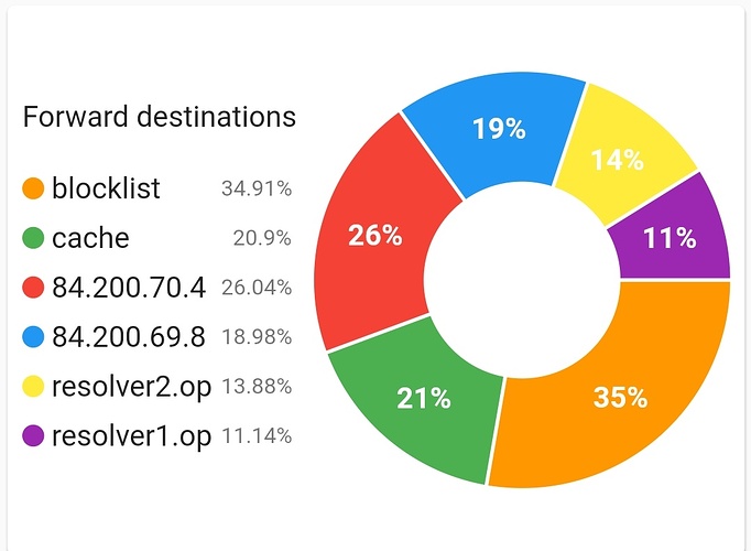

I also did a screenshot via the flutterhole app (the same data, just in a better view). Here you can also see that the overall sum is not 100%!
The sum here is: 126% !

[img=234,176,,,"60 + 30 + 30 = More than 100%"]https://tweakers.net/i/a1fU4Fv-aDUzC-EGZx9VOZpShvU=/234x176/filters:strip_icc():strip_exif()/f/image/f5EmJJlAToX0YVjehctIuiry.jpg?f=fotoalbum_medium[/img]
This basically shows 60% + 30% + 30% = 120% :see_no_evil:
Same thing here.
I see 11.7% + 17.1% + 18,9% + 69% which sums up to 116,7%
  • The display at the top of the page is the blocked percentage of A and AAAA queries only.
  • The pie chart tells you the blocked percantage of all queries.

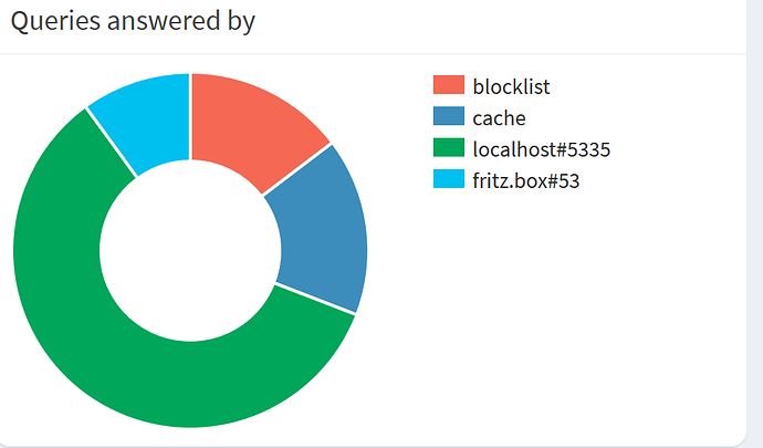

The discrepancy between the numbers on the chart and the chart itself is due to the fact that the numbers add up to more than 100 %, the chart obviously can't overlap itself. My guess is that some queries are accidentally counted in more than one category and so the individual categories add up to more than the total.

My guess was correct, when memory is filled from the database, for example after restarting pihole-FTL, queries that were blocked after CNAME inspection are counted as blocked and again as forwarded to the associated upstream server. They only go once into the total queries, though, therefore the total percentage goes over 100 %.
