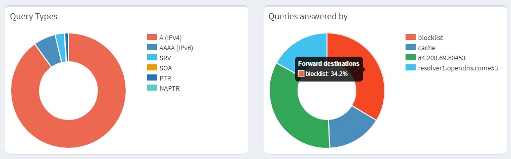

I'm referring to my first Thread, where the percent calculation did not work (link below).
Meanwhile this was fixed, but today I found out that the issue still seems to exist. Even if it's not that extrem anymore... maybe this is typicall german behaviour :wink: , but the overall percentage does not match 100%. So I think there must be something wrong.
Pie Chart: Sum of all single elements should be 100%
Left Chart: 90 + 6,2 + 2,6 + 1 = 99,8 %
Right Chart: 34 + 15,9 + 34,4 + 17,4 = 101,7 %
I know, I know, I know... shame on my head. This must be very picky and neglectable (what I want to say in german: mega pingelig und zu vernachlässigen) but from my perspective, It's wrong. So there must be an error. It's absolutely not dramatically, but does not show the reality.
Regards,
V.

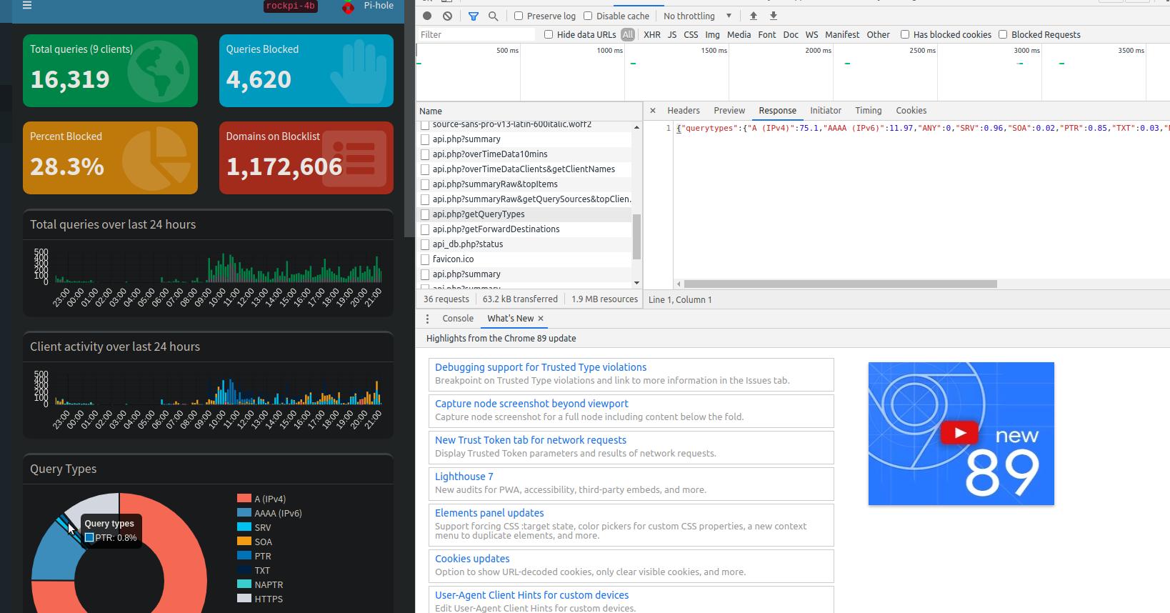

You need to look at the raw data, the chart already does some rounding.
You can access it via http://pi.hole/admin/api.php?getQueryTypes
e.g. my PTR is 0.85%

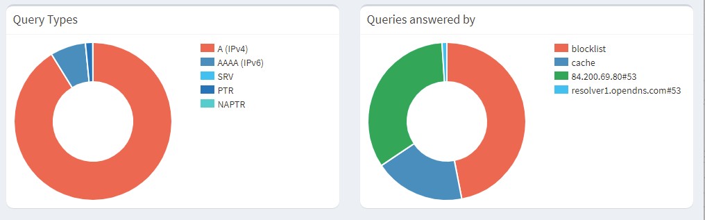

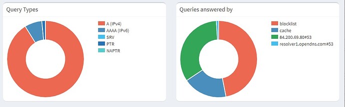

sure, here we go:
output is:
{"querytypes":{"A (IPv4)":91.18,"AAAA (IPv6)":7.27,"ANY":0,"SRV":0.02,"SOA":0,"PTR":1.49,"TXT":0,"NAPTR":0.03,"MX":0,"DS":0,"RRSIG":0,"DNSKEY":0,"NS":0,"OTHER":0,"SVCB":0,"HTTPS":0}}
and here is a screenshot from the same moment:
right chart: 48,8 + 19,3 + 34,8 + 1,0 = 103,9 %
