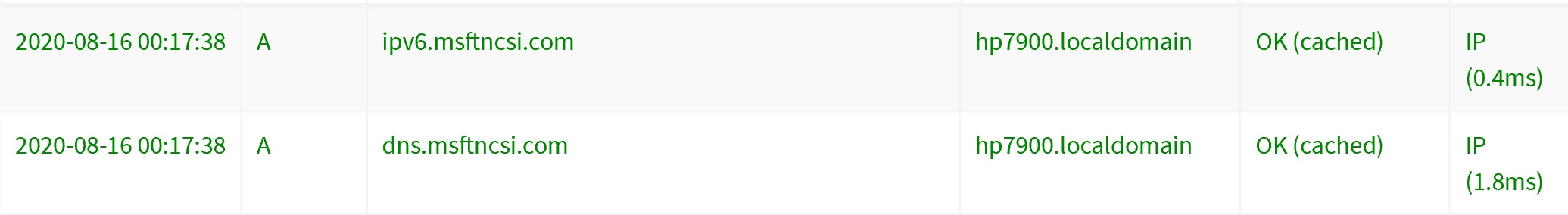

I was lookin into the unknown query result and found a solution for that, I changed my proposed dnsmasq configuration file, see here, to overcome that problem (you need to change the domain name localdomain into your domain name)
Everything appears to be working with this configuration, the unknown entry in the query log is gone.
