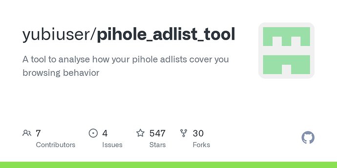

Please note, discussions on this topic along with code examples and updates should take place at GitHub - yubiuser/pihole_adlist_tool: A tool to analyse how your pihole adlists cover you browsing behavior Issues and Pull Requests.
