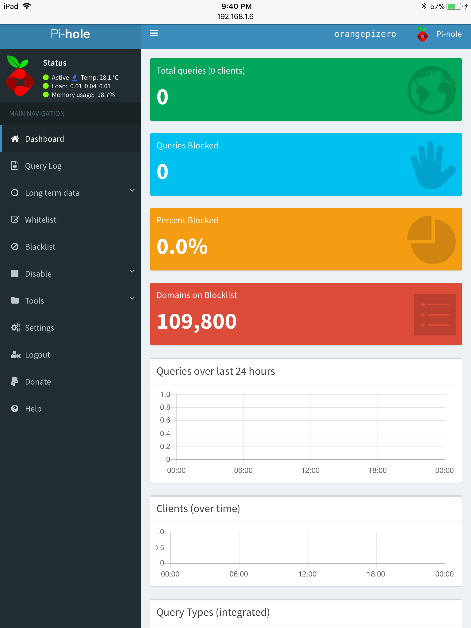

Web Interface not showing any queries
the pihole web interface is not showing any queries even though it is blocking contents just fine. the log files are empty in /var/log

yes that’s the one. i have tried reinstalling and reconfiguring but nothing seems to work.
I mean, is that the whole output from pihole -d?

i set up pihole on orangepizero(static ip) with TP-LINK adsl router as default getaway.
Check if disk is full with below one ?
df -h
sorry for the late reply.
it seems my /var/log directory was full due to syslog logging some recurring error. fixed it up, cleaned the backup files and now everything is running fine. thanks.
