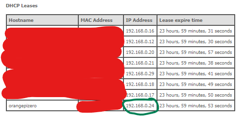

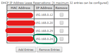

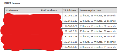

Another weird thing is that even though I have assigned it a static IP with the router's interface - see picture:
the board itself does not appear under the current DHCP leases table. It does, however, use the correctly assigned IP, but apparently the router may have trouble recognizing it - see picture:
The only way for me to get it to appear there is if I remote to it (since it's headless) and run this:
$ sudo dhclient -r eth0 && sudo dhclient eth0
Then it appears like so:
but only until router is restarted or lease expires. It does not reacquire a new lease.

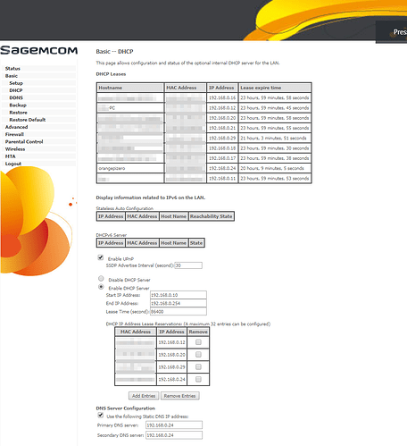

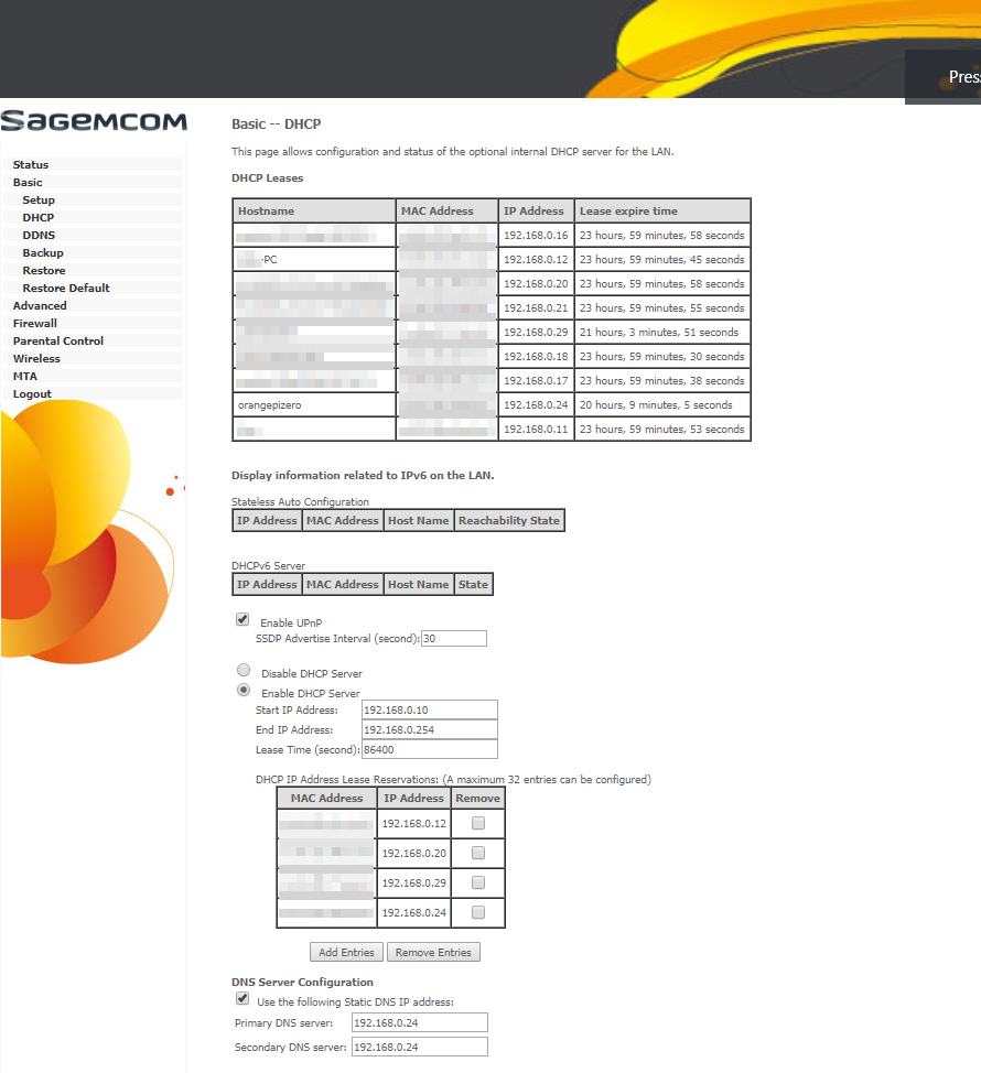

Thank you deHakkerlaar for your very detailed answer! I learned something new from it.
The screenshots you requested, I have added just in my previous reply. I have only missed the DNS settings on my router, so I add them here now:
DNS Configuration
For completeness's sake, here is the full configuration page under DHCP in my router:

Lastly, I would like to not have to resort to using the Pi-Hole's DHCP service, as it used to work fine with that of my router for 1+ years.
Alright, it appears your router is lacking a DHCP setting to push DNS servers to the clients.
It only allows you to configure the upstream DNS server for your router.
This setup should work but resulting in no stats being displayed on the admin web GUI for individual clients.
Only the router DNS queries will be logged and displayed!

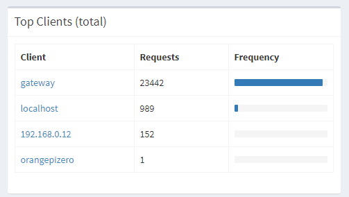

I am not certain that is the case. I have been running this exact same setup with this router for approx. 6 months now. The only difference has been updates to the Pi-Hole and the OS on the Orange Pi Zero. All devices on my wireless network used to be able to access pi.hole/admin - from phones, to Macs and PCs. I also had their queries logged in the Web UI. This issue new behavior I cannot track for the life of me. I looked closer based on what you said:
and CURRENTLY, I believe you are correct because this is what I see in http://192.168.0.24/admin:

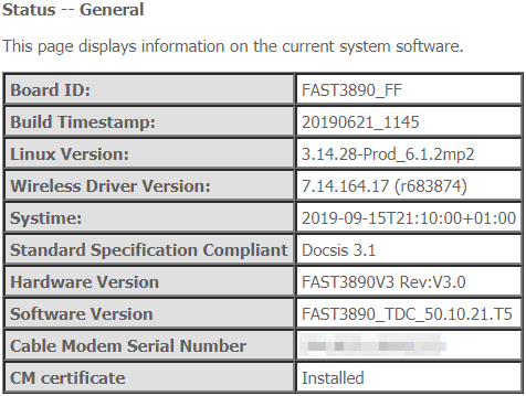

Did you update firmware for the router ?
It might also be that your ISP pushed a firmware update or change.
Ps. routes seem to be ok so ignore :wink:
I asked my ISP the same question about 6h ago over email, since they're not working for the day. I expect they answer first thing tomorrow morning. It would be a major letdown if that were the case.
I will write back when I have more news. In the meantime, I am open to suggestions. The router's brand is Sagemcom FAST3890V3 Rev:V3.0.
General info (hope nothing identifiable is present in the screenshot :smiley: ):
One more I can think of, live tail the logs on Pi-hole (replace "<WIN10_PC_IP_ADDRESS>" with actual IP):
tailf /var/log/pihole.log | grep <WIN10_PC_IP_ADDRESS>
And run that query again on the WIN10 PC to see if it triggers a log response:
nslookup pi.hole 192.168.0.1
Yes, activate Pi-hole's DHCP :wink:
