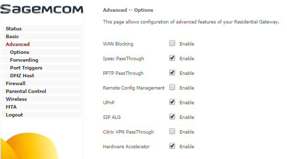

Could this also be Rebind Protection ?
I have nothing of the sort, unfortunately. This is my Advanced Options config page:
It's possible. There may be some kind of trigger for .hole TLD. Something that tells the router to not forward or answer unreachable domains.
