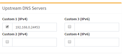

I have also added my Pi-Hole's IP to the upstream DNS settings in the Settings tab (the "#53" was added automatically):
Why have you done this? Pi-Hole needs an upstream server to get DNS resolution, it cannot do this itself. By the time an upstream server is needed, Pi-Hole has already seen the request.
To be honest, I seem to have misunderstood it's function. I will remove it promptly. :upside_down_face:

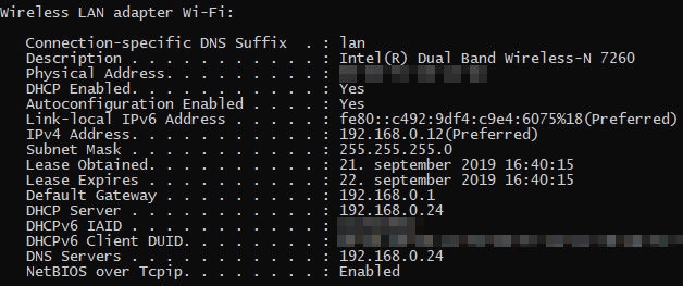

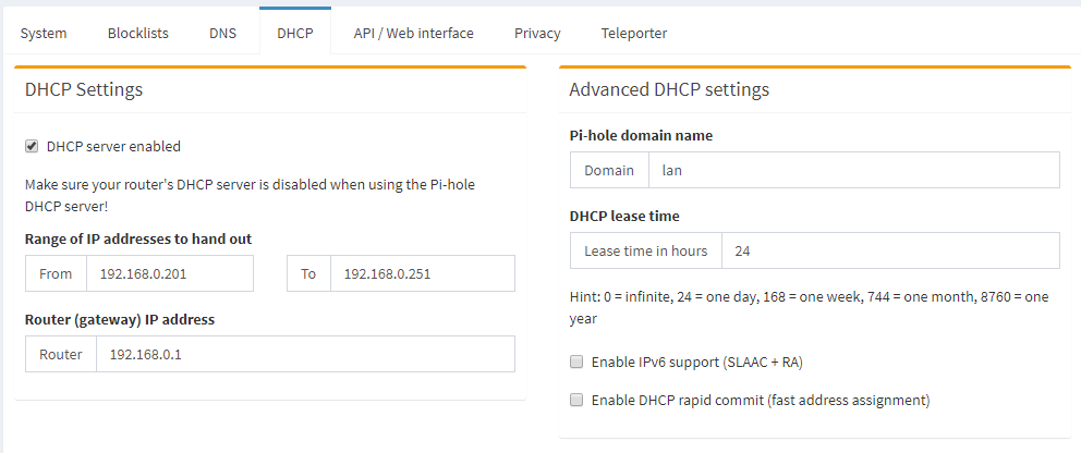

To clarify, I have now the DHCP and DNS server on my PC set to the correct: 192.168.0.24 as seen here:
by enabling the following DHCP settings on the Pi-Hole:

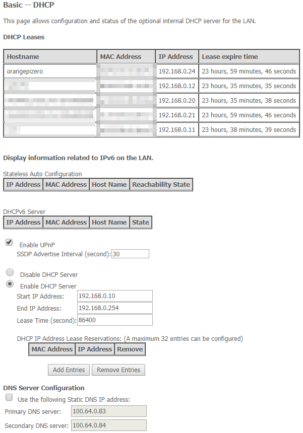

AND keeping the DHCP on my router ON like:
Any attempt to disable it, as instructed, has rendered my network unconnectable. I tried both with setting the checkmark on the router's DNS Server Config and putting the Pi-Hole's IP and without it. In both cases, after I disable the DHCP, everything crashes, no matter how many times I restart the router, the Orange Pi or the clients.
Having both DHCP services active is bound to cause troubles.
On the Windows PC, when you have Pi-hole DHCP enabled and the router DHCP disabled, try run below ones to renew DHCP lease (note time as you will need later when inspecting logs):
ipconfig /release
ipconfig /renew
And check details:
ipconfig /all
