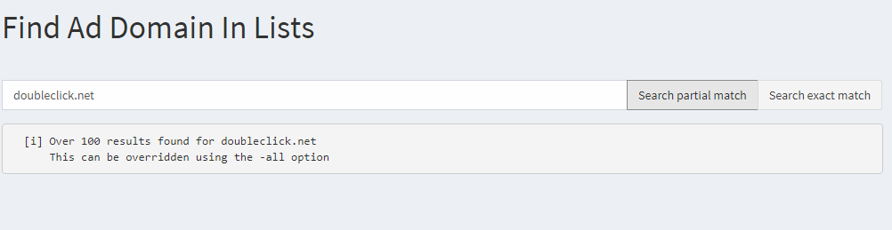

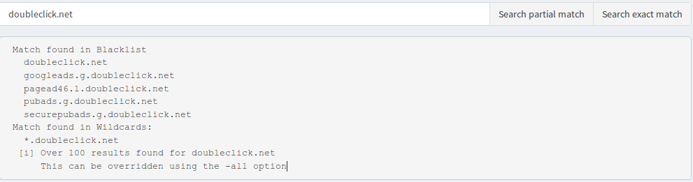

query your pi-hole adlist (Tools/Query adlists) doubleclick.net
It should be there already.

Indeed, it is!
ping doubleclick.net from the PC.
Does it resolve to the IP of the pi-hole?
https://paste.ofcode.org/wNm9zwJUx2rMv6kdBYLNga
Wierd... ?It does not!
