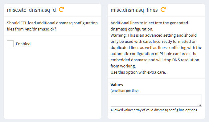

Custom dnsmasq configs not loading
Sorry, this probably should have been expanded upon in the announcement post as part of the section about streamlining config files. By default, Pi-hole v6 will ignore anything in the directory /etc/dnsmasq.d, however – all is not lost! There are two settings of note here:
Either enable misc.etc_dnsmasq_d to restore the “old” behaviour, or if you have only a few lines you can add them directly to the misc.dnsmasq_lines setting instead. Both of these settings can be found in either the toml file, or on the web interface under All Settings -> Misc
