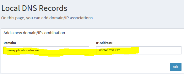

I just added that use-application-dns.net domain with the actual IP 63.245.208.212 (from a lookup against Google 8.8.8.8):
Before:
pi@ph5:~ $ host use-application-dns.net localhost
Using domain server:
Address: ::1#53
Aliases:
Host use-application-dns.net not found: 3(NXDOMAIN)
After:
Address: ::1#53
Aliases:
use-application-dns.net has address 63.245.208.212
