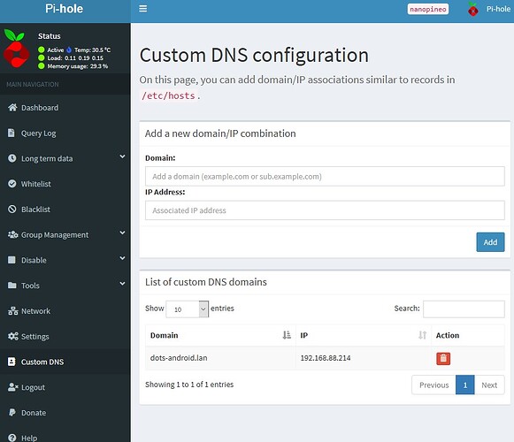

Would like to see a DNS server ability to add DNS records for things within my LAN.
