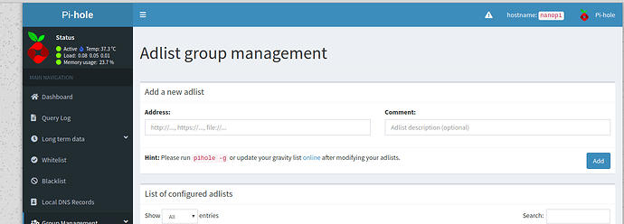

@yubiuser Check out the web interface screeshot in this PR to see what I meant with "something more in the pipeline".
This is awesome ! :smiley:
If you want some help on testing just give me a ping.
Regards Markus
:heart_eyes:
That's awesome!
One small hint: I've tried this in conjunction with new/diagnostics and it is already great that the icon changes when new messages arrive. But the triangle icon is always present - subconsciously I always think something might be wrong even when it is not. Maybe you could change the default symbol to something else not triggering a brain warning.
Something seems to be broken for you. I don't see the triangle when there are no messages available. Note that there should also be a small orange label with the number of available warnings.

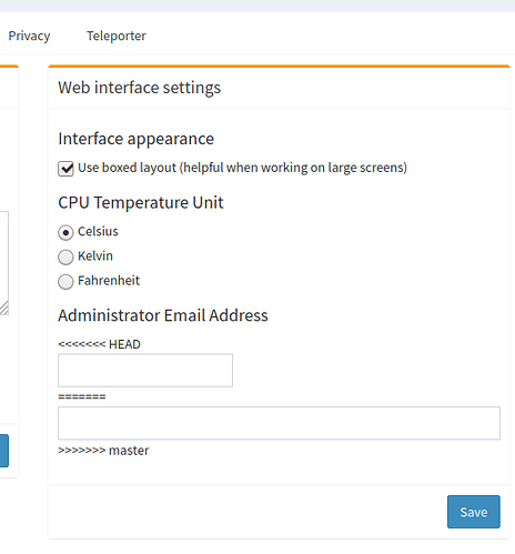

Switched back from tweak/debug_token and the triangle is gone.
The only thing that remains brocken is this HEAD>>>> MASTER seen on API/Web_Interface.
Great feature!
