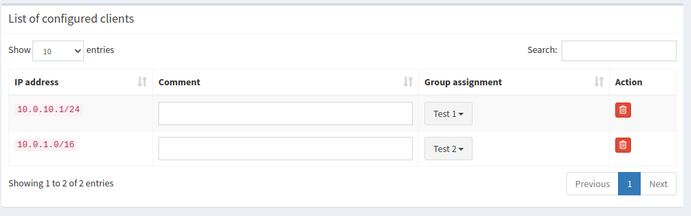

While playing with subnet assignment I came across the fact that there is no output to which groups a client belongs if different (non-identical) subnets are defined.
I created "subnet clients" /16 and /24 and assigned different groups to them. Connecting a device in both ranges, only the /24 should apply. But there is no indication (on cli and web interface) to which group the client was assigned in the end.

That does work as expected and trigger warinings. But it does just work for identical subnets. It does not warn (no reason for warning, just a indication of group assignment wanted) for subets that are within a bigger subnet.
Sub1: 10.0.1.0/16 - Test 2
Sub2 10.0.10.0/24 - Test 1
Which Group will be assigned to Client: 10.0.10.136 (best match would be /24 - Test 1)? And where can I see which groups have been assigned at the end?
Ah, yes, sorry, I missed that above.
The best match will be assigned. Warnings are only generated when the best match is ambiguous (like 10.0.1.0/16 and 10.0.2.0/16 (which is the same thing).

I think the verbose output and DEBUG_CLIENTS were introduced with this commit and are only availabe in new/mac_clients and will like be not part of 5.1.
You are right, I missed that. The more verbose output will come with Pi-hole v5.2 in this case.
