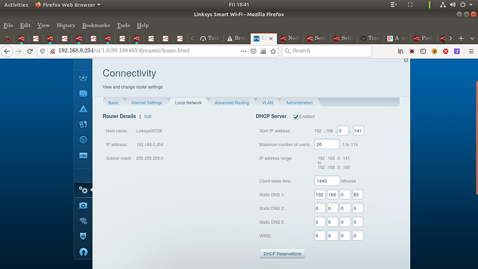

This is what the router config looks like:
192.168.0.83 is PiHole
I rebooted the machine and still getting an error when I go to tools/network.

Your WAP is supplied by your router, or is it a different device?
That screen would imply you are already distributing Pi-hole as local DNS server via DHCP.
It may take clients some time until their DHCP lease expires before they pick up the new settings.
From your screenshot, this should happen within 1,440 minutes (a day), unless you did change and decrease that lease time only recently.
You may force a client to renew its lease, e.g. by dis- and reconnecting to the network or by power-cycling the device.
