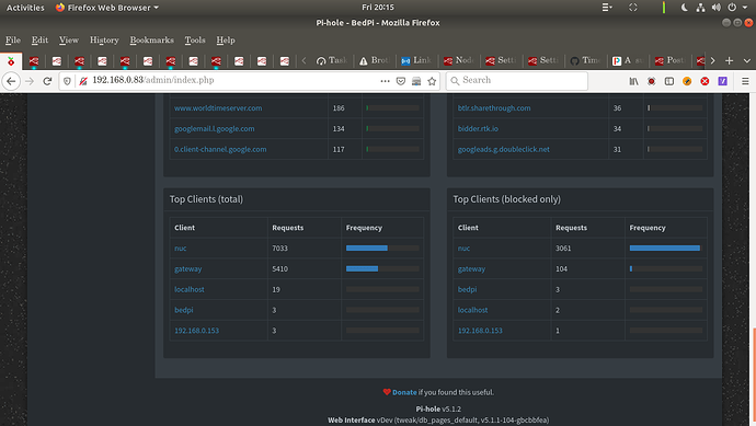

Could you please provide another screenshot of the dashboard's Top Clients?
This would imply that your Laptop is acting as expected, using Pi-hole as DNS as provided via DHCP.
Can you confirm that you did connect your laptop wirelessly through your WAP?

Your LinkSys Linksys WRT1900ACS router named gateway with IP address 192.168.0.254 is sending thousands of DNS requests to Pi-hole.
This would imply that your router is forwarding DNS requests to Pi-hole as received by your clients, and it would be consistent with those clients not appearing themselves in Pi-hole.
We've verified that a WiFi client (your Win XP laptop) is using Pi-hole as DNS server upon connecting via WiFi, so your router's configuration is correct, at least for the WiFi network your laptop connected to.
Currently, other devices still do not show up, and gateway still seems to be sending DNS requests towards Pi-hole.
