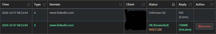

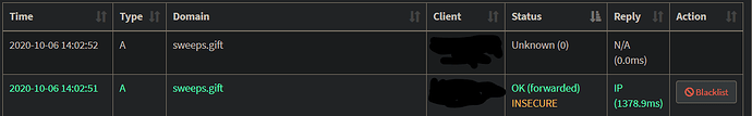

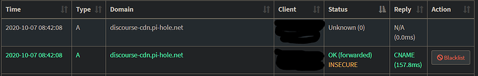

Some websites are showing up as unknown in status while others work
[all websites should return some answer from the DNS set in the settings, and should be either blocked or allowed by pihole]
[some websites randomly return unknown when trying to resolve, thus not being able to reach those websites. clearing the network table and restarting the PiHole some times helps.
this is also confusing, due to the fact that if I sort the logs by status the top ones are unknown after that you get blocked, then approved, and then blocked again. so some entries appear as blocked but on the bottom.]

Please provide some examples.
Log excerpts or screen shots for sucha lookup will do.
this is an example of what the unknown looks like, this one has received a response, but when the issue happens it's just the unknown. sadly I forgot to take a picture of what happened earlier today before I cleared the network logs, but it happens every 2 to 3 days like some cache is filling up and not releasing.

https://sweeps.gg/giveaways/1000-giveaway-e6qcn/
this link produced this:
and this I know for a fact came from my browser. I use Opera as my main browser.
This depends on your chose remote control. It is unlikely, though.
I just tried the link myself and about 60 queries were made. sweeps.gg was queried (as expected) when navigating to this page, however, sweeps.gift was never requested.
The response for sweeps.gg is A = IP, AAAA = IP. All green.
When manually enter sweeps.gift, this seems to give a different page. The response is A = IP, AAAA = NODATA

ran into the same problem i had where pages don't load with this picture.
I'm not going to clear the logs, this is what I got.
/var/log/pihole.log:19086:Oct  7 08:52:04 dnsmasq[22636]: 534 192.168.55.132/61982 query[A] www.linkedin.com from 192.168.55.132
/var/log/pihole.log:19087:Oct  7 08:52:04 dnsmasq[22636]: 534 192.168.55.132/61982 forwarded www.linkedin.com to 1.1.1.3
/var/log/pihole.log:19092:Oct  7 08:52:04 dnsmasq[22636]: 536 192.168.55.132/61982 query[A] www.linkedin.com from 192.168.55.132
/var/log/pihole.log:19117:Oct  7 08:52:04 dnsmasq[22636]: 534 192.168.55.132/61982 reply www.linkedin.com is <CNAME>
/var/log/pihole.log:19118:Oct  7 08:52:04 dnsmasq[22636]: 534 192.168.55.132/61982 reply www-linkedin-com.l-0005.l-msedge.net is <CNAME>
also I'm starting to notice a trend that everything that's not from the cache shows up as insecure. don't know if it's related but it is strange since the test for dnssec passed.
EDIT:
these are all unknown.
