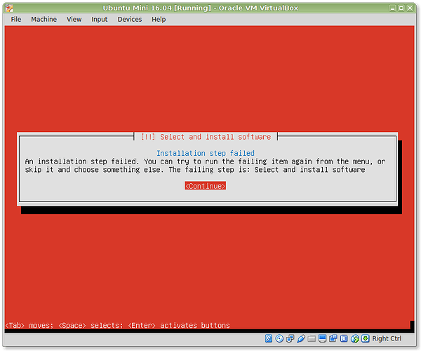

Okay, so it seems to be an issue of the Mini version of Ubuntu? I'm just preparing a virtual machine for it...
Yep -- just the mini version of Ubuntu. No problems running pi-hole on Ubuntu Server.
I have not been able to install it on a ordinary VM (Virtualbox, enough RAM and disk allocated), so for now let's just accept that it works fine on a regular installation.
