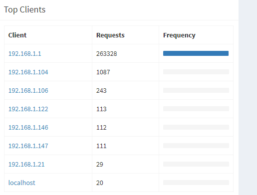

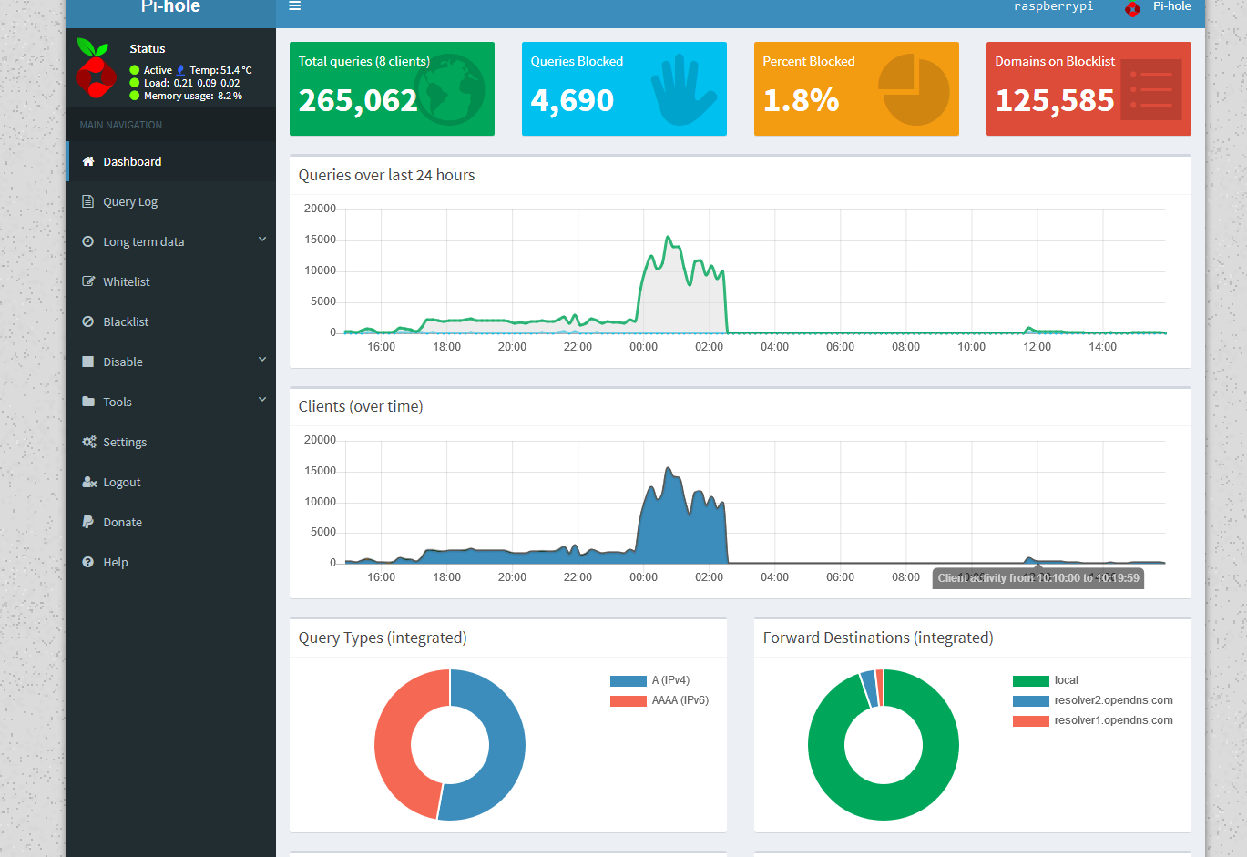

Screenshots for illustration:
afbeelding
Both in both cases it returned the spinning wheel. Why does the log file not shrink or compress or rotate?
What can i do to fix this?
The log file does rotate and compress. However, you have many hundreds of thousands of queries on your network within 24 hours, and that data needs to be stored somewhere. You have one or more clients (hiding behind your router) who are making a lot of queries.
So how do i figure out which it is?
Check the queries, see if anything identifies it (amazon device making queries to amazon). It looks like you have devices already pointed to Pi-hole instead of the router, so it might also be the router making a ton of queries.
One way is to turn off all the devices connected to your router that aren't shown as individual IP addresses (those are tracked individually by the PiHole as shown on your screen shot). Then tail the pihole log, and turn devices on one at a time. You'll soon find the chatty one. I have found that IOT devices tend to do a lot of network queries (phoning home, checking network status, metrics, etc.),

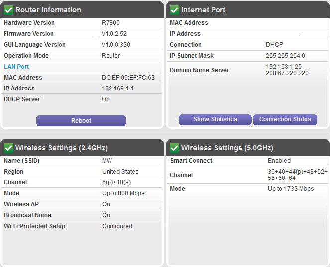

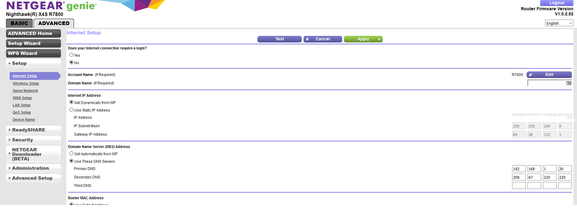

Okay, thanks. But if I change the DNS in the router all my clients will also start to use OpenDNS and they will bypass the pihole. I do not see the use of the Pihole then. I dont want to configure all my clients manually and i cant change DHCP options on the router to set DNS. There is no option to set it up (netgear r7800)
Are you sure there is no setting like WAN DNS? If not, then you can disable DHCP on the router and enable it on the Pi-hole.
See this topic above for my settings on router. There is one dns setting in the router which i can set on manual or automatic.
Then try using Pi-hole for DHCP.
@wvkreg Your router does not support setting a LAN dns. Set your Router's DNS away from your Pi-hole, or it will keep hammering it with requests. You will need to disable DHCP on your router before your Pi-hole can serve as the DHCP server.

Ok all good and i understand.
But then how is the PI my dns server since i set the router to Opendns?
Is it so that if i set the PI as DHCP that i will automatically catch dns queries?
When you use Pi-hole as DHCP server it will explicitly tell all clients to use it as DNS server. Your router has no influence on this setting on the client's as the DHCP server is responsible for the entire network configuration. The router will only be used as a gateway to the Internet but nothing more.
